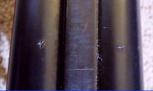

The rifle is in hand. Its a James Macnaughton and it turns out to be a variation of a 577-500 No.2. Not sure if the "40" stamp makes any more sense now. Its got a 7-groove bore and near as I can measure its .506 - .507dia. That seems undesize. ? ? There is a strange "star" stamp on each barrel above the chamber. Anyone know what those means? (see pics)
Anyone have any suggestions or comments?

Buck, that 40 is a mark from the proofing process that identifies the bore diameter of the barrel before the grooves are cut.

Your .506/.507 number - that's the *groove* diameter that you are stating there, no?
What is the smaller number - what is the *bore* diameter of your rifle?

36 gauge is .506". If the bore is that big it should have been stamped as a 36, not a 40. As stated earlier the 40 stamp would indicate a "Bore" that would accept a .488" gage but not a .492" one. This would give groove depths of from .007"-.009" per side. I think this would be normal for a Black Powder rifle shooting lead bullets.
