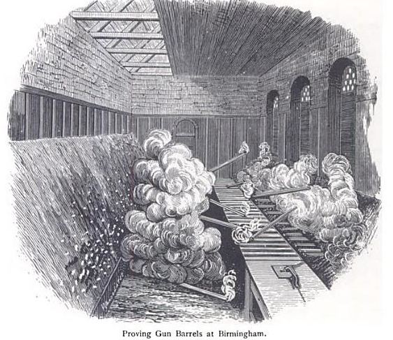

On most guns "Made in America" you will not find the definitive proof marks. On some you will find the provisional proof marks, but not all. none of my Lefever guns have any proof marks at all, though I know that some have the Belgian provisional marks. The provisional proof was a proof applied to a rough tube, un-finished on either outside or inside & un-chambered. Definitive proof was applied after the barrels were essentially finished & had been joined together.
My feeling is that American makers bought the tubes "In the Rough", bearing only the provisional proof & then finished them to their purpose. In the process of finishing many lost enough metal on the OD to lose the provisional mark.
If you find a set having definitive proof then that set of barrels was jointed & finished in Belgium. I cannot say absolutely that none were, but I have yet to see a set of barrels from a noted American maker carrying these definitive proof marks.
Thanks for this information 2-piper!! I should study the proofing process more. I can't envision how they contained the proof load in a rough tube.

It appears to me that the variation in your barrels is just the result of using a ribband that had a differing composition of iron and steel. Whether this was intentional or accidental is a matter for conjecture.
I'm interested in what you said about rough barrels having a coating of sulfuric acid applied before shipping. I'd assume this would have had to have been neutralized after bringing out the pattern, or all you'd see is a coating of heavy rust.
It has always been my understanding that what Miller says about the proof process is essentially correct. I believe the tube are rough bored for the provisional proofing, but they are not chambered. But I have never been able to find out exactly how the proof houses breeched or contained the proof charge in unfinished and unchambered barrels.
Posts: 12,129
Likes: 867
Posts: 12,129
Likes: 867
Leave it to YouTube. Apparently, a temporary breech plug is fitted during initial proof. Here's a link to the video. For some reason, I can't attach it here:
https://www.youtube.com/watch?v=f3aHnxsj7y8
