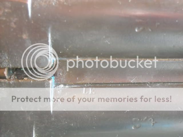

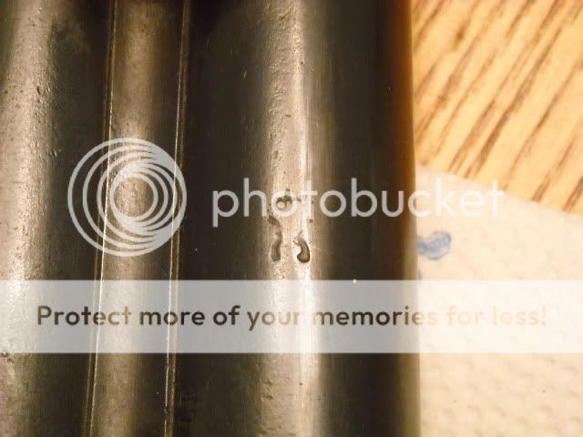

The only stamping on the barrel is the number 120 and there are no proof stamps either only a number 1 and number 61 on the flats any help or information would be of great help/interest The lack of stampings on the receiver is strange. There is a stamping between the fireing pins it is Ansch & Seele # 347 Brevete. Could this be a very early gun if 347 is a serial number like the other gun pictured ?

IMHO, if 61 is the serial number, it falls into the first Lindner serial number sequence, A&D makes it post 1874, and the absence of the first Lindner mark dates it pre-1877. So, Heinrich's father Georg was controlling production at that time, and figuring approx. 15 guns per month production, makes it possibly made in 1875.

I just looked at the ser # it is 61 engraved on trigger guard so may be a very early Linder gun with out stampings I was wondering why so little stampings and no proof marks now I am thinking this is a very early Linder there is an other stamp on the barrels but is so small looks like typewriter keys even with a 10 power loup I can not make it out the quality is poor compaired to the other stamps on the gun. I will steel wool it tomorrow and see if I can make it out it is so small hard to see it is stamped.
