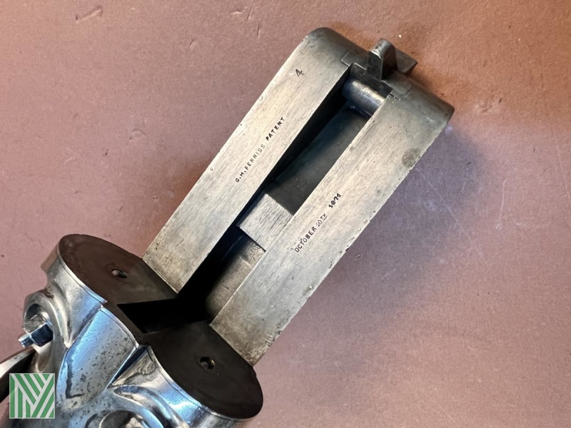

Daly Nr. 4???
Marc made a nice find on this Charles Daly on the Ferriss Patent that sold on E-Gun.
Lindner wasn't involved as he didn't have his Gunmaking Sheepskin just yet. Also, the tubeset has the initials >>PB<< & was part of a Scott Gesteck/Partskit....

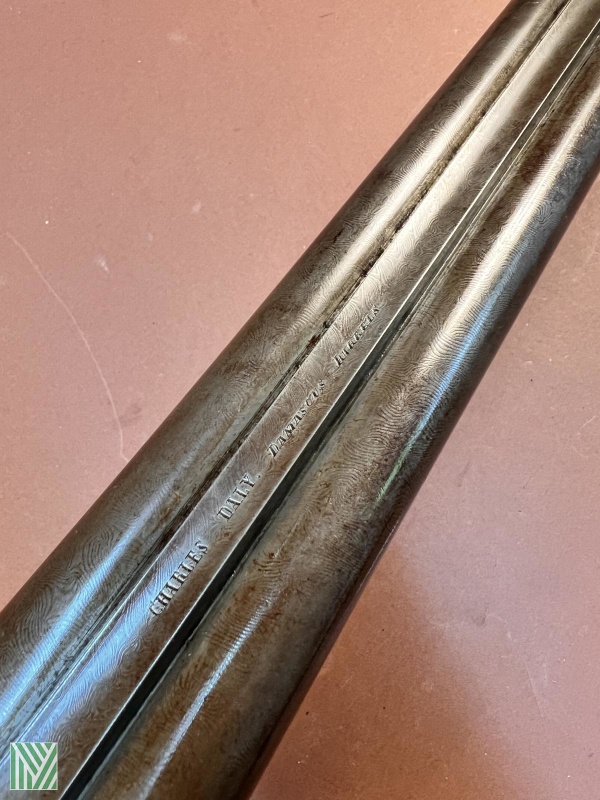

Raimey: that gun has some sort of large scroll Damas Crolle
The old thread re: Cluny has lost the images.
Early SD&G catalogs listed the Lindner Dalys as having Cluny, Bernard, Turkish First Quality and Chine (Ferlacher Chine was also Turkish)
Cluny is in France north of Lyon and not far from Geneva - more famous for Burgundy & Benedictines than gun making.
There is also a Cluny Castle in Aberdeenshire. Cluny means "from the meadow" in Gaelic and is an old Irish boy's name
Unfortunately I've never found documentation of a "Cluny" pattern...but some day the Damascus Pattern Rosetta Stone will be unearthed! smile

Too, I cannot say that they are Belgian sourced, possibly England? Depends on where Scott was sourcing their tubes?
Posts: 10,034
Likes: 642
Posts: 10,034
Likes: 642
A messy 2 Iron brother, and Ferlach made lots of damascus barrels
Is that 'MV' on the L barrel? Likely the tube maker.
