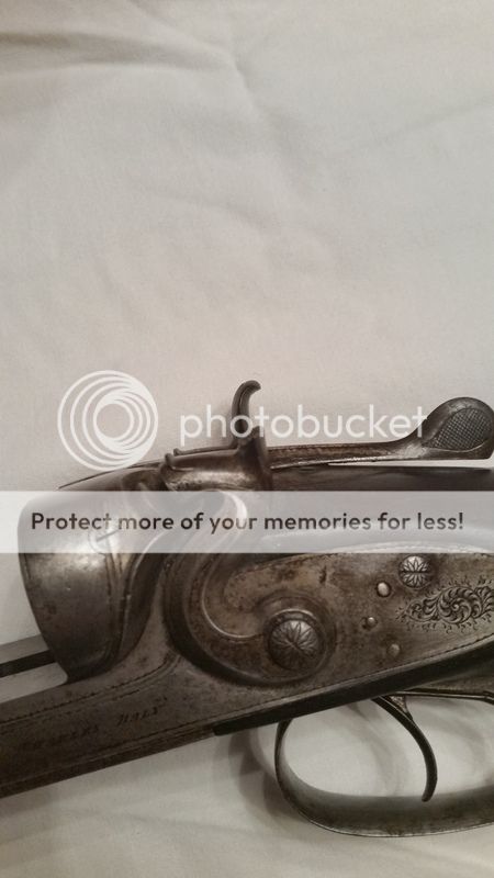

Thanks Ken...You all know your stuff. How about a fix on this hammer? sorry, lots of questions.

3 options. 1) have the original hammer repaired, (2) have someone who knows what they are doing make a new hammer, (3) buy a pair of matching reproduction hammers. I guess there is a 4th option which would be finding an original. It may be possible to find a different matching pair from an old parts gun of some kind that would work.

To fix that hammer I would remove it from the lock & weld a piece of steel to it then shape it & cut checkering grip on it to match the other.
You retain engraving this way & have the correct hammers.
To replace hammers is easier said than done because they are timed & shaped to fit the tumbler on a square & that is an individual thing.

Do you like to file? Would you like to learn to? If so, have a piece of mild steel welded onto the broken hammer and file it back to shape. You have a pattern to go by with the right hammer. You will feel a great sense of accomplishment when you finish that job. I'll bet you can do it. Just the kind of job I would take on.
