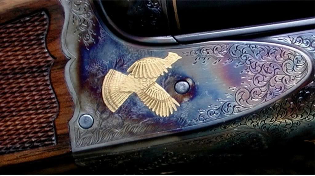

I'm going to post a picture of a Fox that I did many years ago that Oscar color cased for me. Its hard to describe the colors but they are lovely and transparent - best I can do for a description.
Oscar did indeed have an ego - don't we all! He was, however a professor of electrical engineering and computer engineering at the University of Illinois when he retired and was at the top of his game when it came to firearm metal finishes at the time. He also had a wonderful but dry sense of humor.
