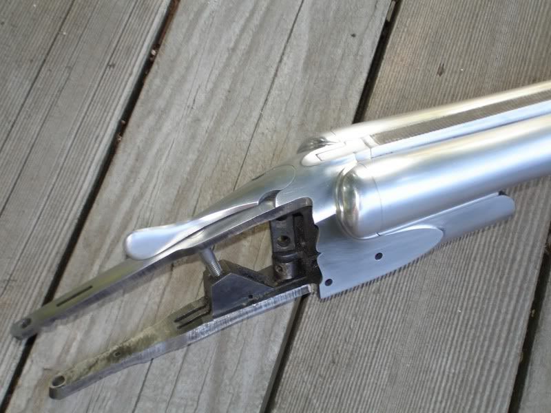

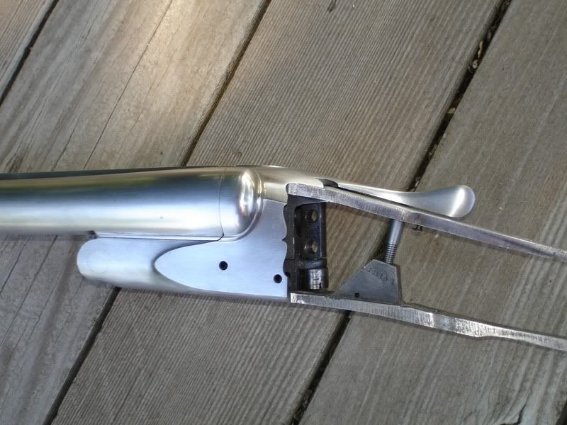

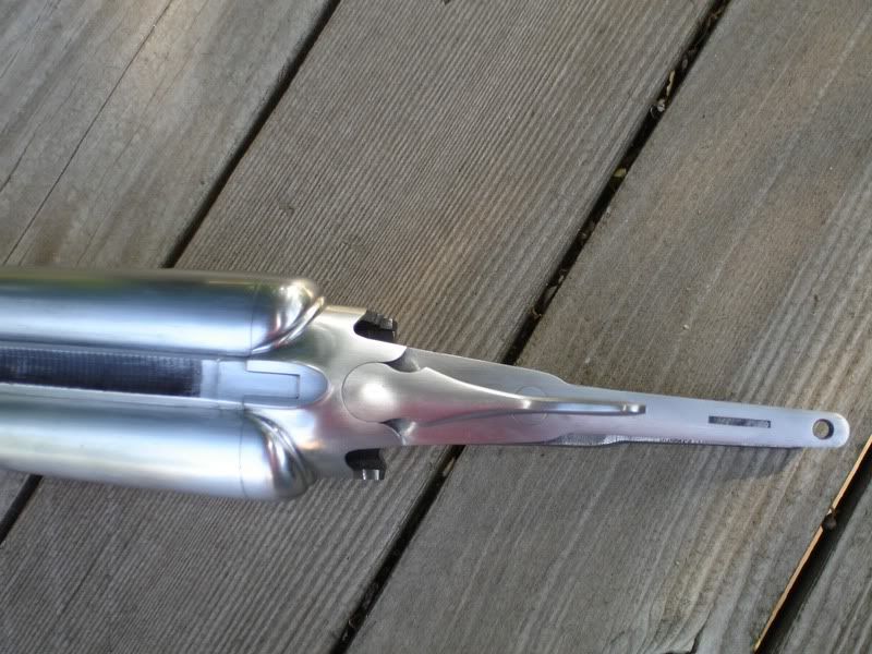

Doug, I never thought of that but Song of the South should be just right for Mr. Glenn. I haven't seen those pictures since I cut the gun.
