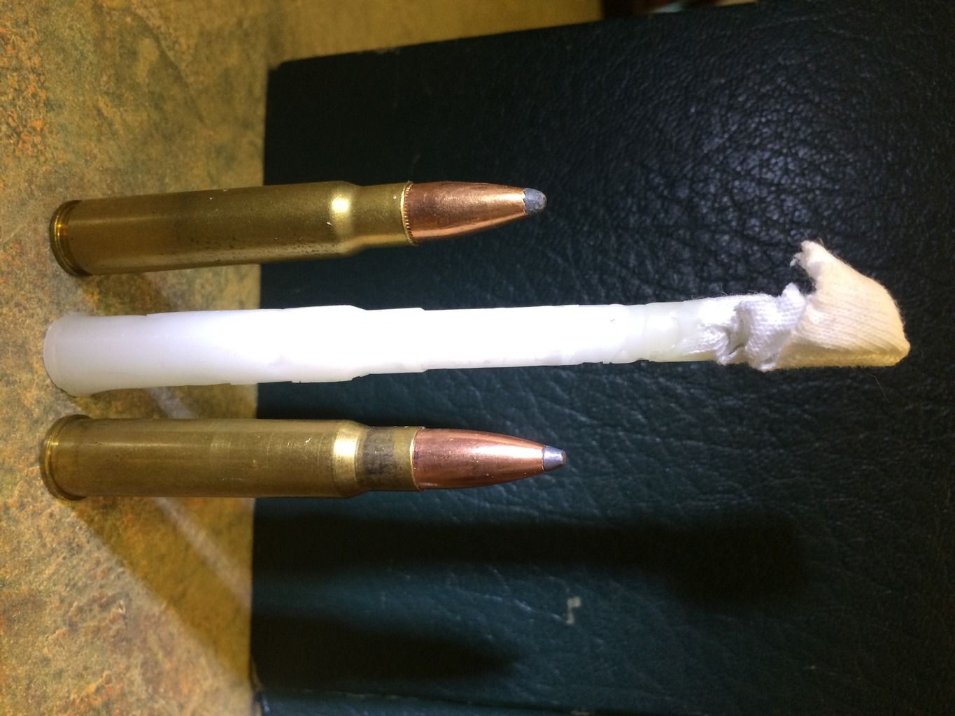

runswithelk,
In your first post, you said it wouldn't close on a 7x57 case. Contrary to popular belief, the 7x57 is not simply a necked down 8x57. As in Axel's comments, posted by Raimey above, the 8x57 is based on the M88 case. The 7x57 case is known as the M93 case, which has a head diameter larger than the M88 case(nominal .468"vs .473").Rim diameters and thickness are also different between the two. The bore diameter of 7.7mm is pretty tight, but is often seen in commercial barrels. If when you slug the bore, you find a groove diameter smaller than .318", I wouldn't be overly surprised. The chamber neck would have been cut large enough for a .318" bullet( maybe larger)and will be perfectly safe with commercially available 8x57IR ammo, such as S&B. Enjoy your very fine gun, it will give many years of good service.

Hi Mike,
Thanks for your input on the combo. Yeah, when I bought the firearm, I was told it was a Walter Outschar, 16 Guage 2 3/4 over 7x57R. I was curious so I loaded in a 16 guage shell and a 7x57R round. Well, of course, it wouldn't close. I had already done some investigation on the stamps and proofs and it started to become clear that the combo was not as represented. That's when I joined this forum. You folks have been excellent help. I certainly appreciate everyone's input. Thank You.

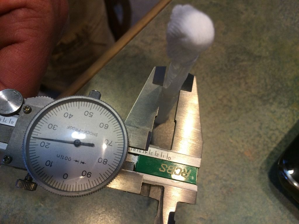

According to the chamber cast I made, the dimensions seem very similar to an 8x57. I have yet to find some soft lead to slug the barrel, so I am still uncertain whether it's .318 or .323.
Does anyone have any tips on how to determine actual shot shell length? In looking down the bore with a dial caliper, I have compared it with another shotgun stamped 16/70. The caliper seems to end at the same length, but the angle makes it difficult to be sure.

It's absolutely shure, the caliber is 8x57IR. By this caliber it gave long time confusion between 8x57IR ( 7,7/8,07mm) and 8x57IRS(7,89/8,20mm)written down by RWS handbook Nuremberg 1940.
I use the caliber 8x57IRS and on the box of ammo is written:
"ATTENTION! Only for barrels with the larger S-caliber bores (Bore.310in.,Groove.323in.)
In this book from 1940 aren't any laborations for 8x57IR.
This gun by Aug. Wolf normally takes caliber 16/65 for shot shells in this era, the length is 60mm when unfired
