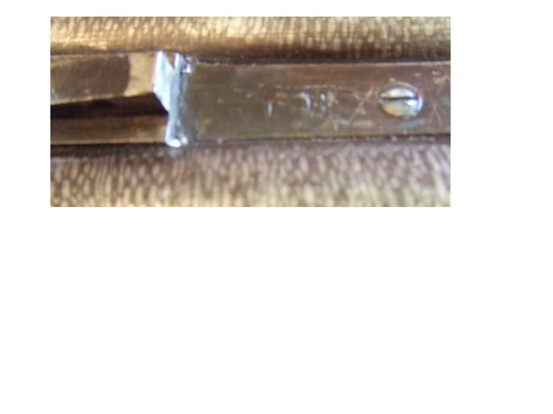

It appears to me that there maybe a mark on the barrels close to the barrel flats. If so, that could be the mark of the barrel maker.

Alex: As Pete suggested, are there any letters stamped on the bottom of the brls or the brl flats? If so, we might be able to identify the maker. For instance: GDH would be Delcour Herket, a J superimposed on a D would be Jean Duchateau, LD is Lambert Dumoulin, or a three-lobed crown over a D is the mark of Jean-Baptiste Delcour-Dupont. Unfortunately, those marks were frequently lost in the fit and finish process.
Distributors also stamped barrels, the most commonly found being SD&G for Schoverling, Daly & Gales, New York City

The only markings, other than the serial number, that I can see is a large E and there is also what appears to be either a J or an I in front of the E.
Here is a picture of these marks, though it isn't the greatest.
