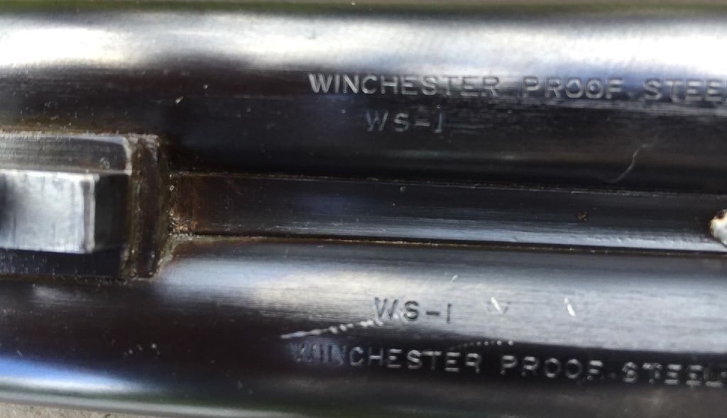

Here's an interesting set of Win 21 barrels.
You tell me, Skeet or Quail??
For NSSA skeet as shot today I'd prefer that to the WS-1 and WS-2 in my gun!!
