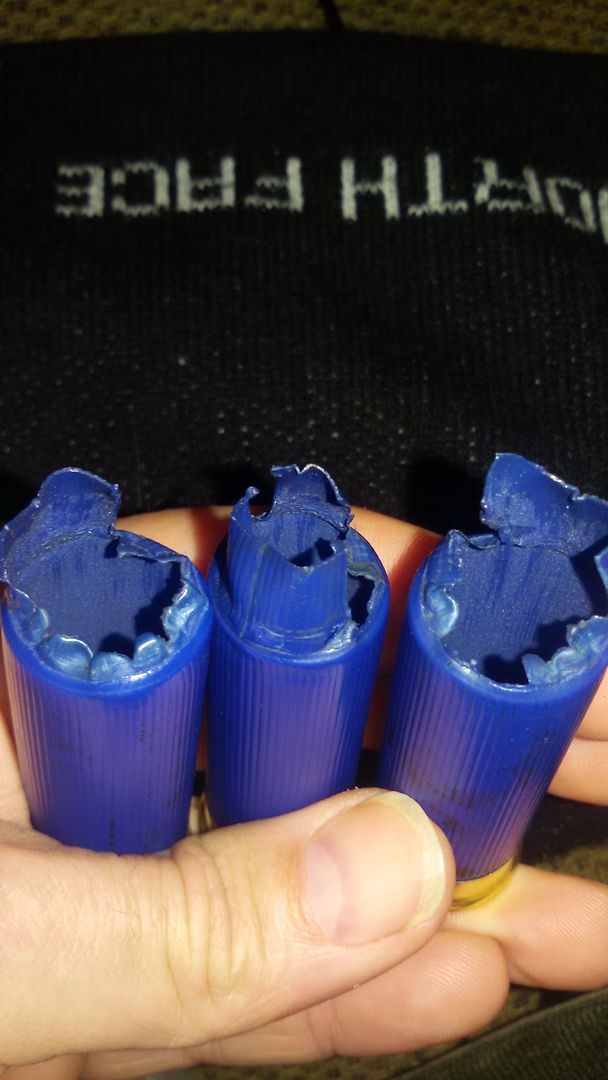

Thank you all for the input. This thread quickly turned in to an interesting read for me. What I am trying to figure out is whether I should be concerned about shooting these shells in my vintage guns. Let me also add that Dan at Nice Shot has been a pure pleasure. Super nice guy and seems willing to provide just about anything his customer wants.
The shells I received are brand new blue shells. I'll try to post a photo of the damaged hulls in a little bit.
Here are other variables to consider, of which I have no idea what is or is not of any value:
The temperature was about 45 degrees, probably warmer.
I ordered 2-3/4" shells. They all measure between 2-3/8" and 2-1/2" and are all shorter than any of my name brand factory 2-3/4" shells, and about the same as the my 2-1/2" RST shells. I thought he had made a mistake with the order so I asked him about that. He emailed back that the hulls all measured 2-3/4" WHEN OPEN. I always thought a 2-3/4" shell was longer than 2-3/4" when open, but a little research on the 'net tells me length is based on the spent hull. He also speculated he must have had the dwell on his roll crimper set a little too high as the reason why they didn't open properly. He said it uses friction to heat set the crimp. The recipe is supposed to produce 8000psi, but I definitely recall noticing the recoil as compared to lead RST loads. Whatever that non-scientific observation is worth.
What, if anything, does the overall length of my shells (2-1/2") tell you about the crimp depth, potential pressure produced, etc? Other thoughts? I'll try to get that picture loaded.

Here are the hulls after being fired.
Could you show a before picture ?

From the photo, it look's to me like he is using way to much hull material to turn the crimp. I use a roll crimp a lot and turn just enough to roll the edge over. Probably just under 1/4 inch and I do not use friction (heat) to set the crimp. Heat causes the plastic to turn brittle and make the hull very hard to open easily. I have reloaded nice shot and not experienced any problems with crimping the hulls. Using Cheddite plastic or paper hulls I have never experienced that problem and my fired hulls can be reloaded by hand rolling them on a wood dowel to even out the hull mouths. Too much material in the crimp and too much friction to set the crimp is my thought.

I thought the same thing as you Eric, heat made the the roll brittle. My guess

I took my pictures to our local blackpowder shop here in town. He didn't look at it very long before asking about my chamber length, saying it looks like the hulls didn't have room to open. I believe a 1898 Parker GH should measure 2-5/8" chambers with Parker recommendations to use 2-3/4" shells so that does seem a plausible explanation. I'll get the chambers measured to know their length for sure. Please comment if anyone sees anything amiss with the way those remaining shells look to you, or if my local guy's theory holds water.
