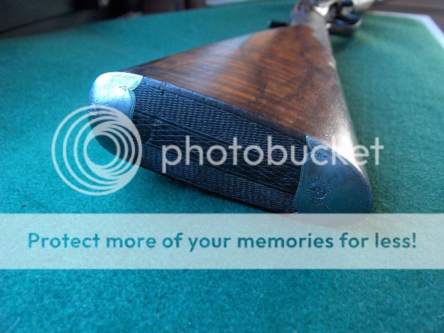

Stallones, mine has steel heel and toe plates. How well does your firing pin retracting system work? Here is a picture of both of my original firing pins. The end of the retracting arm that slides in the groove on the inside of the hammer is broken on one. As mentioned, I'm trying to figure out if it makes sense to either repair or replace the original system. I'll post a photo of the heel and toe plates in a few minutes.

Stallones, Here is a picture of the heel and toe plate and interesting checkering on the butt on my cousin to your Pape.
Rich
