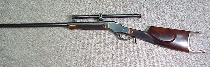

By your picture MP, it looks as tho' one piece of the barrel screws into another barrel section? Not into the action.
Could this be?

Something like this!
Could this be?
Yes, the pictures is of the original False-Barrel rifle, the new barrel screws into the frame. Here is a picture of the False-Barrel rifle with the two pieces screwed together. Looks like an ordinary rifle and if one never saw the seam then it looks normal.
