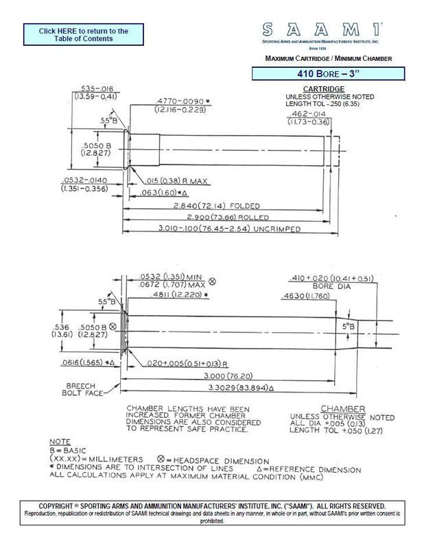

Now, a little homework exercise...calculate the length of the "un-real" .410 shotgun chamber forcing cone below and provide your assessment of its relationship to "modern forcing cone lengths". (tip: subtract the dimension given for the length from the breach to end of the chamber, from the length given from the breach to the end of the forcing cone.)

Chuck;
Chamber dia = .463"; Bore dia = .410; Difference = .053";
.053/2 =.0265"; Co-Tan 5° = 11.43
11.43 x .0265 = .3029; Exactly what is shown on the drawing.
I definitely would "NOT" call this a Long Cone.
The cone length is shorter for the same angle in the .410 than in the larger gauges because there is less difference in chamber & bore diameters.
