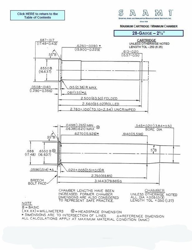

This is a modern chamber/cone drawing. It typifies the modern cone considered to be longer than many early 20th century guns. As you can see, it has a 5* angle per side or 10* included angle cone. A 3* cone measured from either the barrel axis or normal to the barrel axis doesn't jive.
