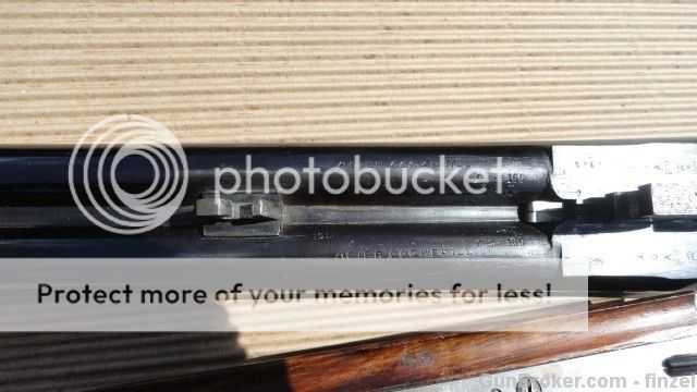

Looks nice but I have never heard of the maker.
http://www.gunbroker.com/Auction/ViewItem.aspx?Item=513361777

Most interesting on Stogos Suhl - "STOGOS" was trademark of the fleeting concern of Stotz & Goessel, Erffastraße 26, Suhl
"STOGOS" war das Markenzeichen der Firma Stotz & Goessel in Suhl. Die Firma baute eigene Waffe und Vertrieb dabei auch fremde Waffen. 1923 von Johann Stotz und Leopold Goessel gegründet. Die Partnerschaft endet bereit 1927. Bis 1930 alleiniger Inhaber Johann Stotz. Die Restbestände wurden von Wilhelm Knopf übernommen.
http://www.deutsches-jagd-lexikon.de/index.php/STOGOS
http://doublegunshop.com/forums/ubbthrea...=true#Post71624
Looks like an i date code and a boxed set of initials DL and Acier Cockerill.

Tolerable LOP, ejectors, scalloped frame with side frame reinforcement attached to straight hand stock with swivel, Purdey Nose? & lovely adornment. It would seem to be a proper choice.
MM.( Messieurs ) Ory et Duquenne, 92, rue Saint-Laurent - 1922
Ah, here it is:
http://www.littlegun.be/arme%20belge/artisans%20identifies%20no/a%20ory%20and%20duquenne%20gb.htm
Ch. Ory et J. Duquenne - 92, rue Saint-Laurent - registered with Liege proof facility 1904 - 1935
Note on the postkarte that Büchsenmachermeister Kurt Jung of Clawerstraße Stuttgart, Allamagne is more than likely a client.

Raimey,
Good morning.
I see the BP and smokeless proof marks, and the 16/70. Can you tell what the proof pressure is?

Bill: After the Liege proof house revisions of 1924, a Certificat d’epreuve could be issued and specified:
“The pressure developed, measured by crusher type device international standard, lower or equal to 600 kg per square centimeter for sizes 16, l2, 10, 8 & 4; 670 pounds per square inch for sizes 20, 24 and smaller.”
600 kg/cm2 = 8534 psi SERVICE pressure;
670 kg/cm2 = 9530 psi SERVICE pressure
+ 10% by piezoelectric transducer measurement.
20 g was PROVED at 1000 kg/cm2 = 14,223 psi
12g PROVED at 900 kg/cm2 = 12,801 psi
Transducer numbers for 20g would be close to 15,500 psi; 12g about 14,000 psi
