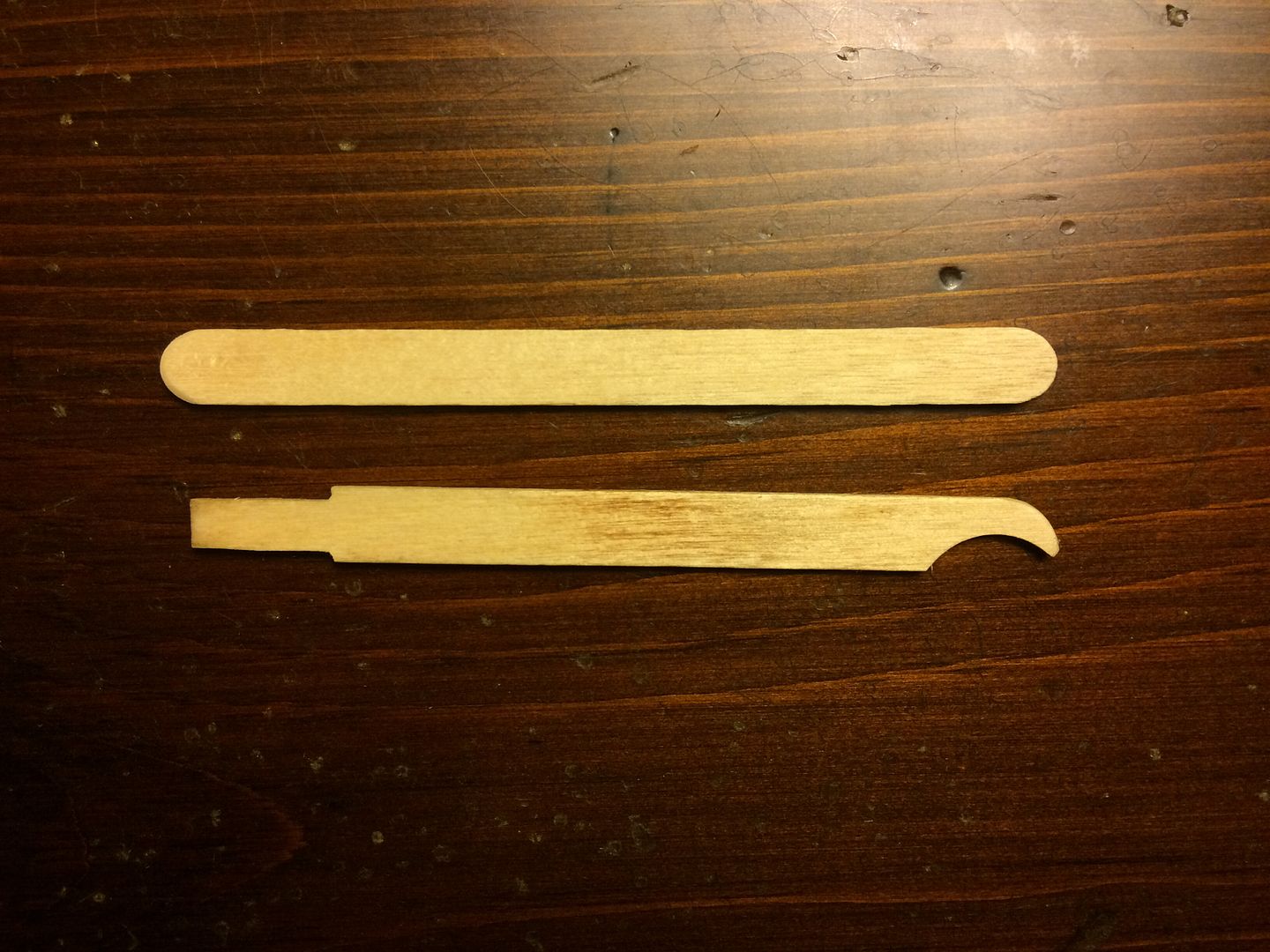

I know, it's high tech but it is the neatest tool I've found for cleaning the hinge pin and action recess. The hook end pushes a cleaning patch all around the hinge pin and even reaches underneath where I was never able to reach. . The squared end is great for cleaning the rest of the action recess. Popsicle stick and it can be made in just a couple minutes. Enjoy!

Thanks, old stick; we knew you'd come through for us dummies w/some serious insight. What a perfectly simple and effective devise! Much appreciate your sharing that.
If there were a thumbs up sign[emoticon, is it?], I'd give ya one.

Joe thanks for the great invention. Bobby

The square end of the tool is also great for pushing out the barrel wedge on early type forends. No marring or danger of doing other damage.
