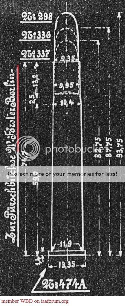

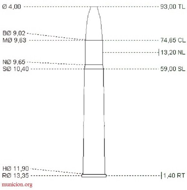

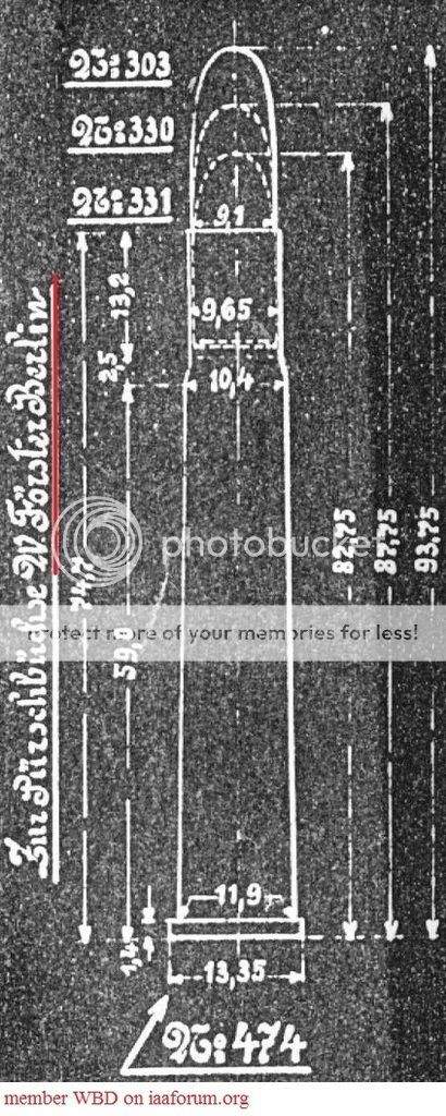

9,3X74,7R Förster cartridge dims courtesy of Peter in Sweden.
