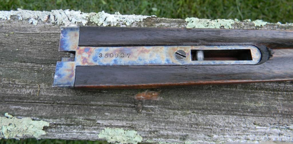

Originally Posted By: Gr8day
Here it is...
imo those are indeed cyanide colors. Doesn't mean they aren't correct dependent on exactly when the gun was made. Do you have a date when it was made?
foxes rule
According to serial number date of production would be 1909/10. Colors must be redone...Geo

Poster said to "check out the colors on this BE AH Fox gun- OK, from the fotos of the forearm iron, where are the ejectors already? I can't find the trips on the forearm iron--Thanks! RWT (AH) F

Not torched. Looks like cyanide.

Fox went to cyanide in around 1918-19 I believe. Here is a good example of Fox bone charcoal case coloring from a 1913 gun. It has the "oil on water" effect of that process.

Yes, just a smudge of "Del Grecoish style" often referred to as enhanced case-color to make gun more desirable to bright eyed young laddie looking for fine American classic.
Extractor gun it is.

looks like cyanide to me.

Thanks for all the input.
The odd thing is the wood: It looks untouched (except for the pad).
And that blueing looks pretty right, too.
Appreciate the help.

I do not believe it was torched, but either a poor charcoal job or something else weird.
I have done some charcoal case hardening and I am guessing that the packing was too loose or some strange charcoal mixture
