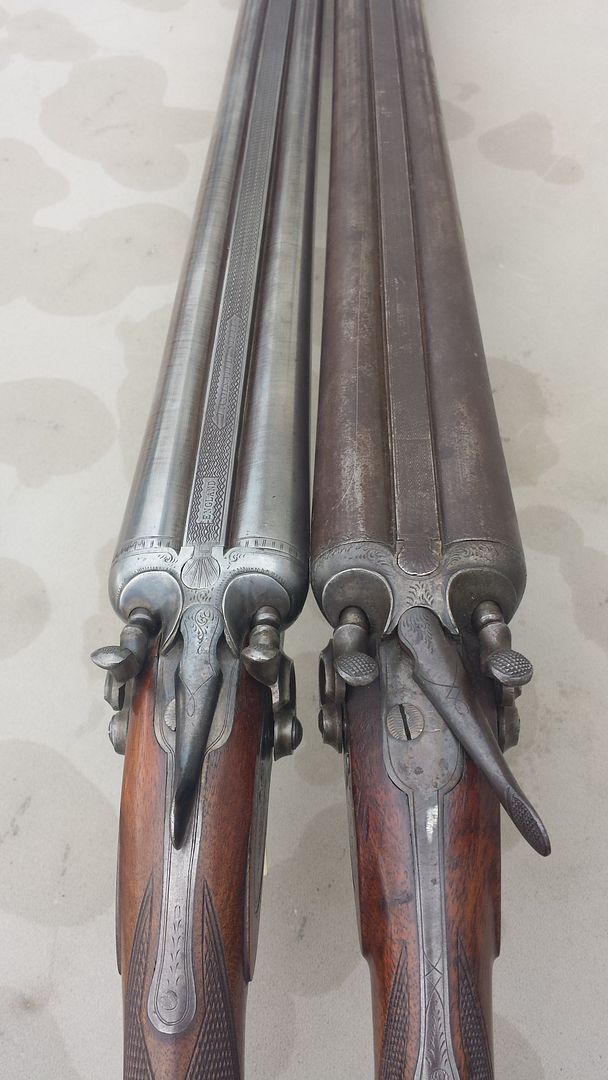

Do you by chance have pics of the Loomis or other barrels, before and after ? Thanks, Daryl
Daryl,
Pics from this thread. When I have a chance, I'll get the Williams out of the safe to reconstruct the first picture.
Before:
Williams on left, Loomis on right.
After:
[/quote]

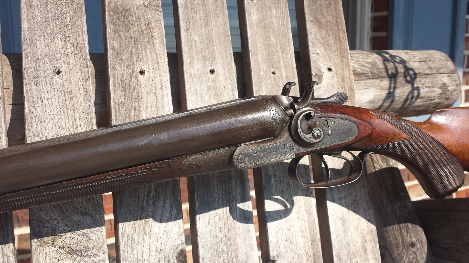

Mike, thanks. Sort of off the topic, but I noticed the offset top tang screws in your pics. I seem to remember this is prominent in Webley and or Scott designs for a period of time. Daryl

Daryl,
Before and after pics of electrolysis process below. Only abrasive used is some 0000 steel wool to scrub off the residue created by the process. Scrubbed with warm water and dish soap, then oiled. Several dry wads of paper towel pushed through the bores. Then oiled.
Before:
After:
The damascus pattern doesn't pop, but much, much better than they started.
The screw is offset and runs through the stock at an angle to the center of the trigger plate. It is offset to allow the toplever spring to be attached to the bottom of the tang. Is this the same on the Webley or Scott's?
This is the spring that is broken in the Loomis.
I made a 'sample' spring from mild steel (spring steel on order from Brownells) as it is bit more complicated shape due to the mounting screw on the end. I may have to start with a piece of vehicle leaf spring as the screw hole is placed in a location that makes it difficult to shape from readily available stock. Will see when the Brownells shipment arrives.

Mike, thanks for the pictures. It sure helps understand what you are doing. Did I miss how much soda you put into your volume of water ? Daryl
Posts: 3,604
Likes: 12
Posts: 3,604
Likes: 12
Daryl,
One tablespoon baking soda to each gallon of water.
