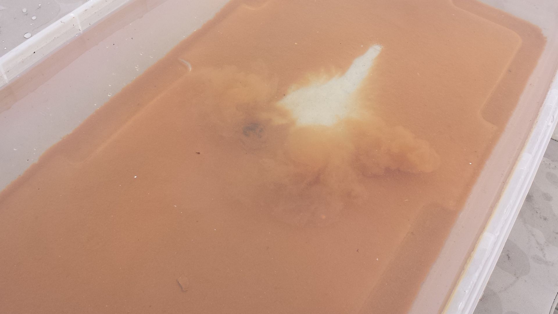

Originally Posted By: Utah Shotgunner
I have another barrel to do, so the tank is still on my back deck. I'll post a couple of pictures, even though the internet has many.
A battery charger and some wire to go with this is my set-up for barrels.
I stirred up the rust on the bottom. This rust came from the Loomis barrels and a Winchester 1200 barrel I did at the same time.
