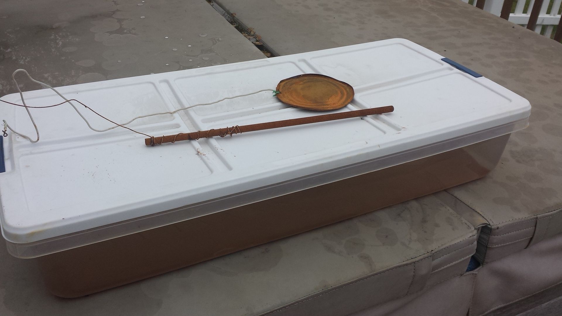

Originally Posted By: Ken61
If you've got a Battery Charger and a box of Washing Soda, you can do it.
I haven't done it yet, but I plan to. I have to find a plastic tray long enough for barrels. I'll use a piece of U shaped steel from the scrapyard for the piece that collects the rust. I'll then make wood blocks to suspend the tubes inside the flanges of the angle iron, so rust is removed on three sides at once. Rotating the tubes will be easy with the blocks.
From my experience, you seem to making this too complicated.
I use a plastic tub I bought at Lowes. I hang the barrels with string or rubber tubing (old bike inner tubes) from dowels across the top.
I use whatever wire I have. Wrap the wire around the lugs or even the barrel itself.
For an anode, I use the lid off a 1 gallon tomato sauce can (For increased surface area) when doing a group of parts like the revolver.
For barrels I use a piece of all thread lying on the bottom parallel to the barrel(s). Have never had to turn or rotate any parts.
I have another barrel to do, so the tank is still on my back deck. I'll post a couple of pictures, even though the internet has many.
A battery charger and some wire to go with this is my set-up for barrels.
I stirred up the rust on the bottom. This rust came from the Loomis barrels and a Winchester 1200 barrel I did at the same time.
I LIKE complicated. It's sometimes the most efficient. It's also a question of space in my shop, I'm cramped as it is. Instead of a tray, I'm considering eight-inch PVC, with a slightly smaller pipe inside of it to collect the rust. It'll remove rust from all sides of the barrels at the same time..
