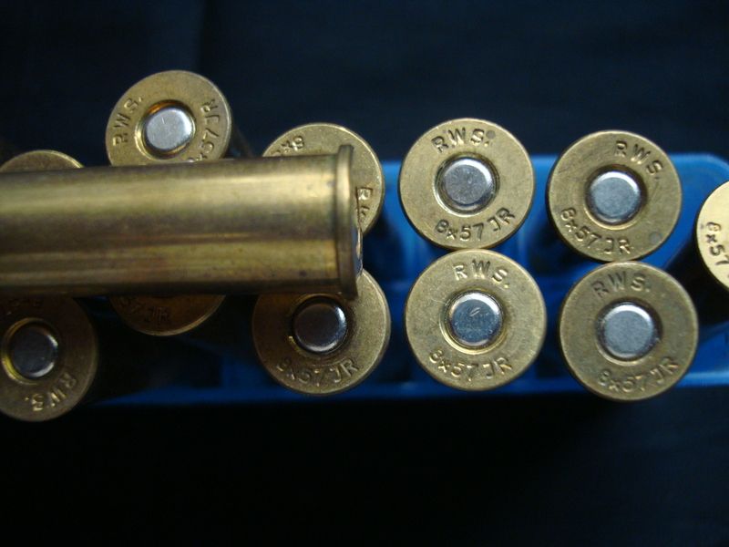

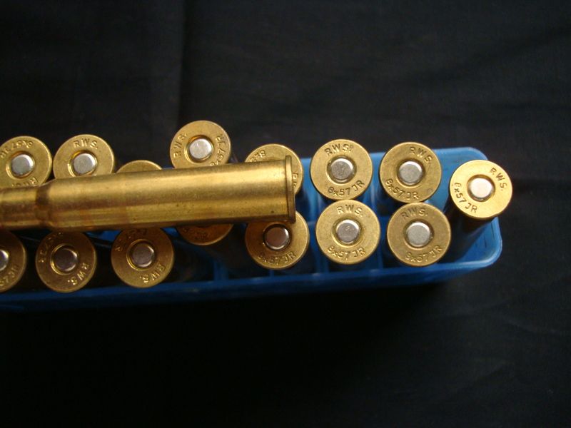

I use RWS ammo for the rifle and it is clearly rimmed as in the pics below:

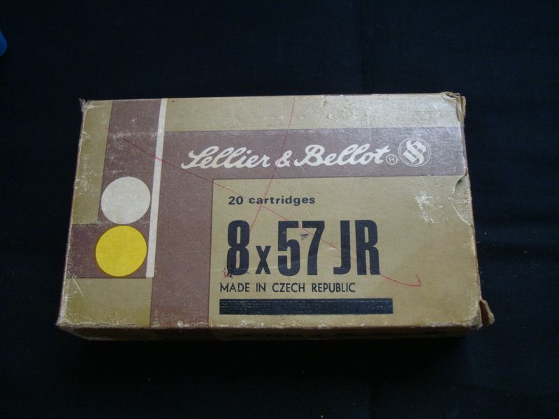

However, a friend recently brought me some Sellier & Bellot ammo marked on the box 8x57JR:

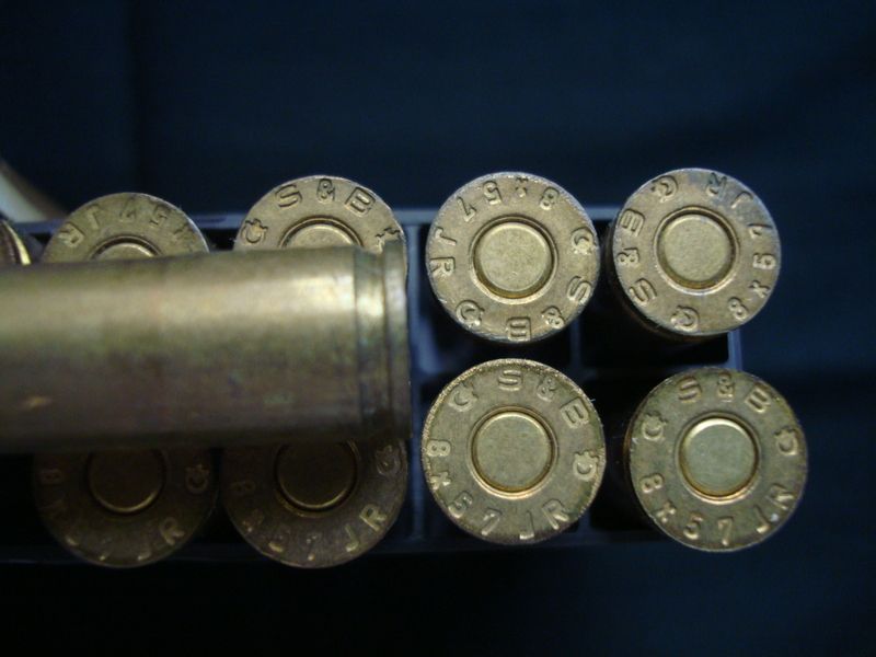

As is the ammo:

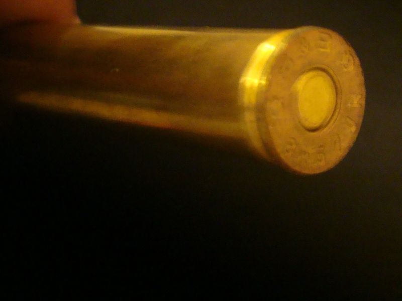

But, as is quite clear from the cartridge laid on top of the others from the same box, it is rimless!
My pathetic attempt to show the rimlessness and the head markings.
Now is the "R" in "JR" for "Rimmed"( as I thought and obviously may well be wrong) or does it denote a difference in diameter between the "JR" and the "S" bullets?
Thanks for any clarification in advance.

I & J were interchangable in the language of the Germans when these cartridges were developed. So IR = JR or Infanterie Rand. Unless the drilling wears a S stamp or if you've slugged the bore & it warrants a S diameter, stick with the IR. Course if you've slugged the bore you'll know the diameter. R = Rand(rimmed).

But if R is for Rand = rimmed ( I am sure you are right) then why are the S&B cartridges marked IR and are rimless!

Rebated? Those S&B's are for a bolt gun & not tip-up.

But since they are rimless the R should not be in the head stamping surely!
I suspect that S&B have screwed up somehow and have either misstamped a J cartridge case with JR. or worse, they have misstamped an S cartridge meant for a bolt gun with JR.

S&B is an old line company and knows very well the difference between the rimmed JR and the rimless J cartridges.While I don't have the cartridges "in hand" to check,I see signs that they have had original rims removed.I speculate that a non-handloader had a bolt action rifle chambered for 8x57J and arranged for the rim of 8x57R cartridges to be removed, without changing the marks on the box and headstamp.There seems to be a great gnashing of teeth when it turns out that a rifle was intended for J ammo(.318)and this seems to be a novel way to make ammo;it seems to have somehow made it to your friend that had no way to know it had been modified. Your intention to continue using JR ammo is fine, but be advised that unmodified S&B ammo will also work.
