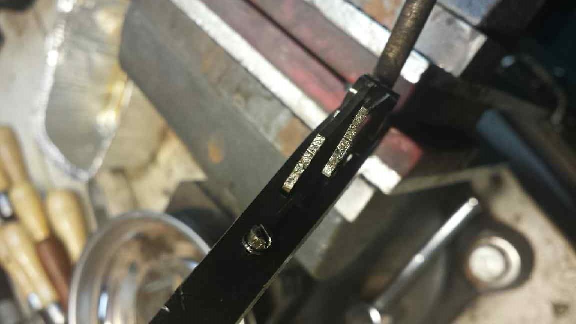

Found "XL" or "IX" to be stamped in several locations on the internals of this shotgun.

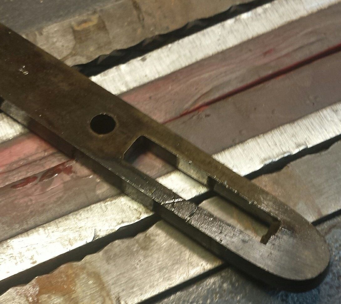

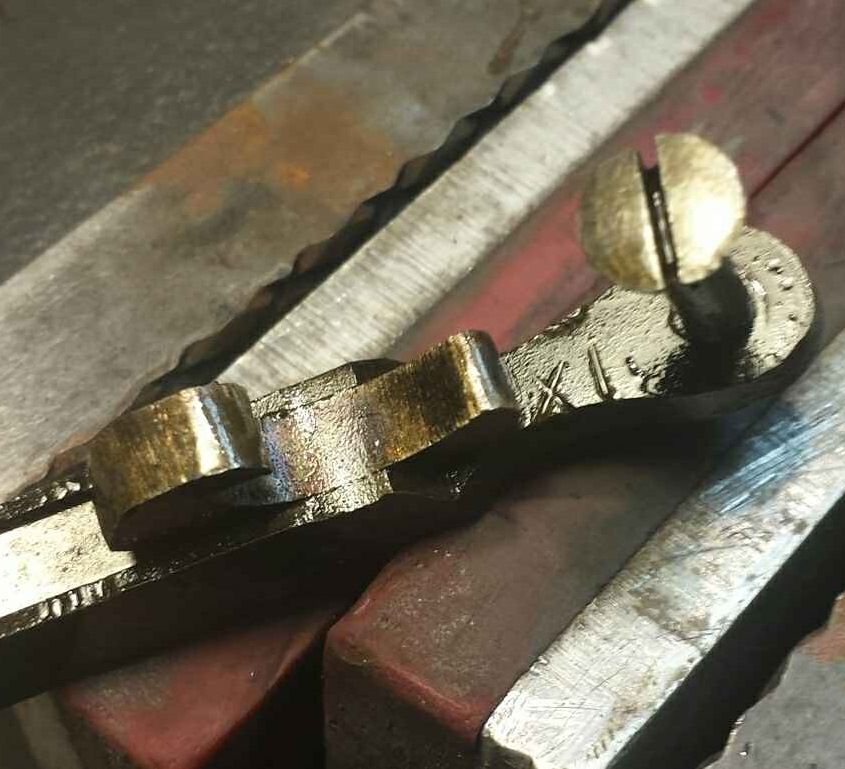

Ken,
Didn't really pay much attention to the pulls. Checked for function and any problems before tearing it down.
So far, I have cleaned surface rust from the barrel w/ electrolysis, boiled all of the metal bits in a Simple Green solution and stripped the grungy finish from the wood.
Making a new toplever spring today.
Metal bits were oiled with a combination of Kroil and 30wt, which will loosen up any surface rust. Will refinsh the wood, re-cut the checkering and then reassemble.
At some point it looks like the horn or ebony forend tip was lost and replaced with a piece of walnut. I might correct that while I am at it.
