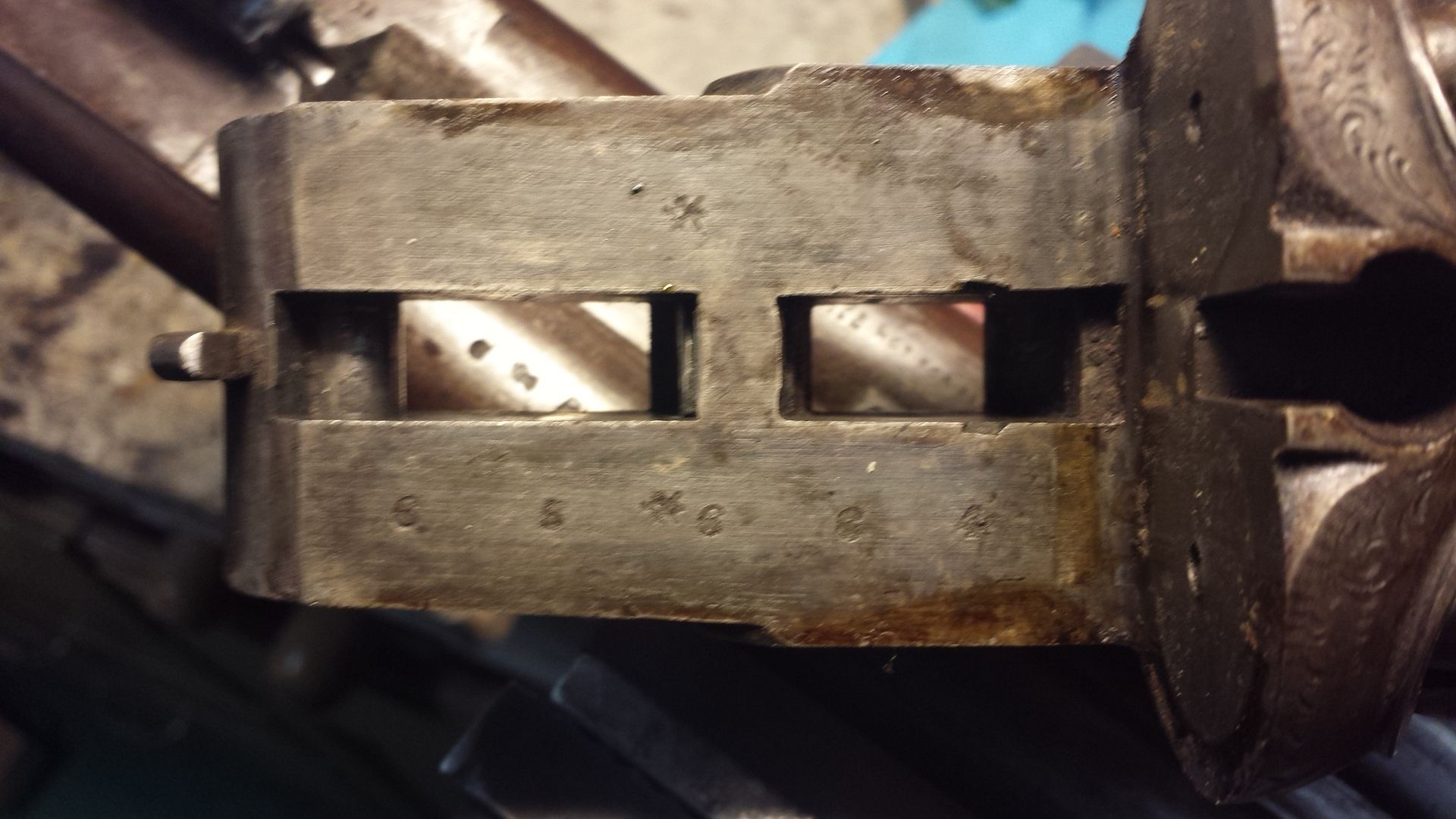

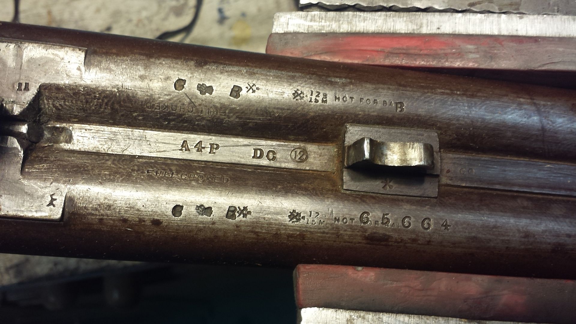

The Williams, Fred'k, i have has IXL no. 9 on both side-plates and the top rib before the dolls head extension, but other than that the engraving is almost identical. Locking bolt looks identical as well. I'll try to post pics for comparison. I spoke with Jack Rowe before I purchased it to ascertain his feedback and he told me he knew Fred. Williams and Company well as that was his first place of employment upon entering the gun trade in Birmingham.
Do you think the no. 9, 20, and 45 were model numbers? I shoot mine on a regular basis for SC. Fits me well and breaks clays with low pressure 3/4 loads.

Any chance for a pic of the proofs? It looks like the provisional proofs will help solve this puzzle. I find DocDrew's post compelling, perhaps lending credence to the theory that after 1890 Folsom began sourcing the Loomis guns from Belgium. My Loomis, an IXL No.18, has a full set of Birmingham proofs. Folsom may have "Read the Tea Leaves" of the protectionism of the day and made the jump by engaging a Belgian agent in 1889...
"Louie, we're about to be messed with. Quick, go register "IXL" as your trademark!"
I have to dig out my list, but I believe that Models 9, 20, and 45 were all on it. I can't differentiate if the guns were made in either England or Belgium, though.

Interesting that the IXL No.18 is a Birmingham gun, yet the IXL models 20 and possibly the 45 are Belgian. I wonder if this is significant as far as the model numbers. I'll try to track it from now on.
susjwp,
Which city proofed the No. 9? Was it confirmed to be Birmingham? I assume so since it's a F Williams.
Utah,
The same question for your No. 45?
