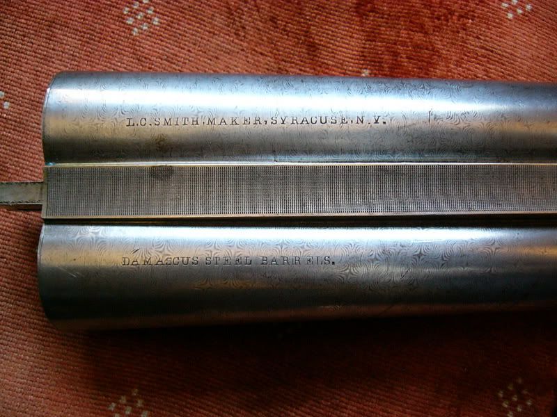

Originally Posted By: PeteM
Gordon,
You don't mention the gun. Is this a high end gun? What condition are the barrels in currently as far the damascus finish? Are they etched black & white, browned or blackened?
Pete, Sorry for the delay in the reply, I just got back in town last night. My guns are not what I would consider high end, a Baker A Grade and an L.C. Smith Syracuse 10 ga, Quality 2. I am just trying to determine if there is any way to make the pattern stand out a little more.
Thanks,
Gordon
