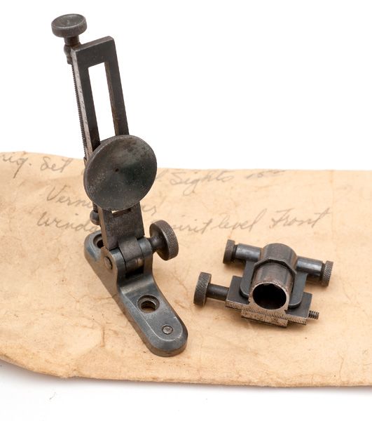

And an orginal set of Ballard Mid range sights:

Very nice action and sights to start a project with! More Pacific actions have been reworked in to custom target or schuetzen rifles, than any other Ballard action made! Hard to beat the forged action, and DST on these actions!

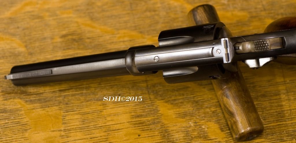

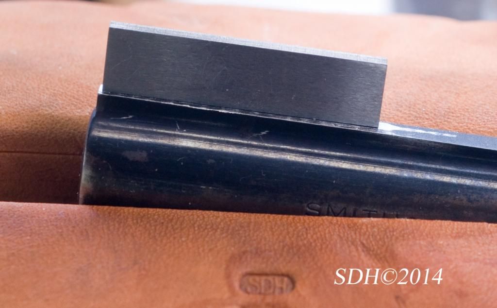

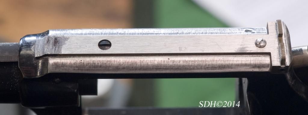

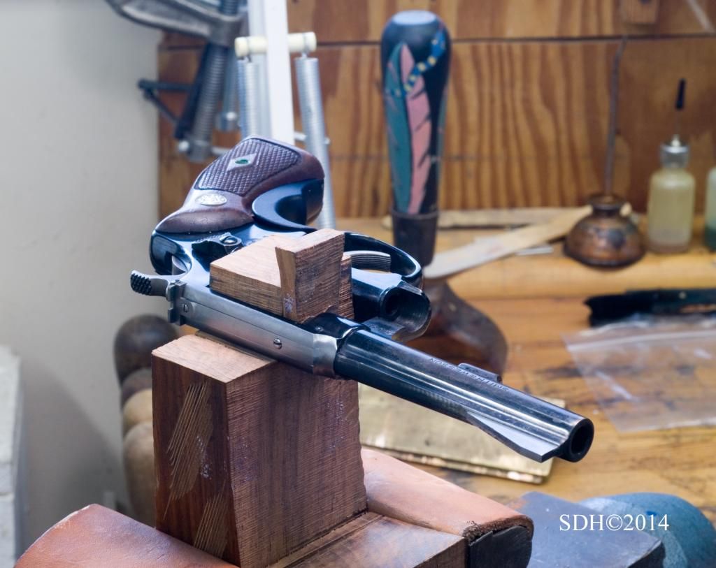

My .32 Kit gun project. Pre-war type adjustable rear sight made and install by another gunsmith friend of mine, same with oversize front blade.
I shaped, serrated and soldered front blade, file fit rear sight and polished to match frame.

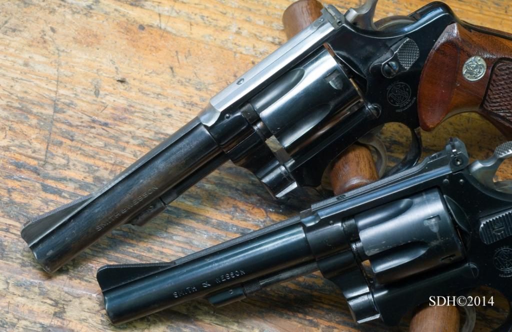

All fit and polished shown with factory .22 Kit Gun

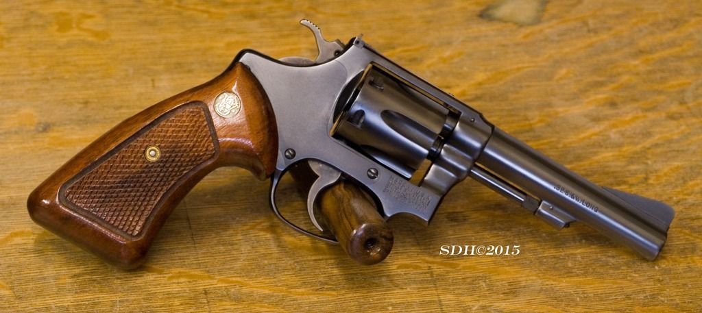

Dan completed hand polishing last week and we gave it a "High Sheen" rust blue.
Never offered from the factory, ready for gopher season with a one-off, .32 Kit gun. Eventually it will get it's own set of fancy custom target grips.

.32 Long wadcutters have some serious thump for small and medium sized critters up to woodchuck/coon size. VERY accurate, usually, too.
Neat custom revolver!
