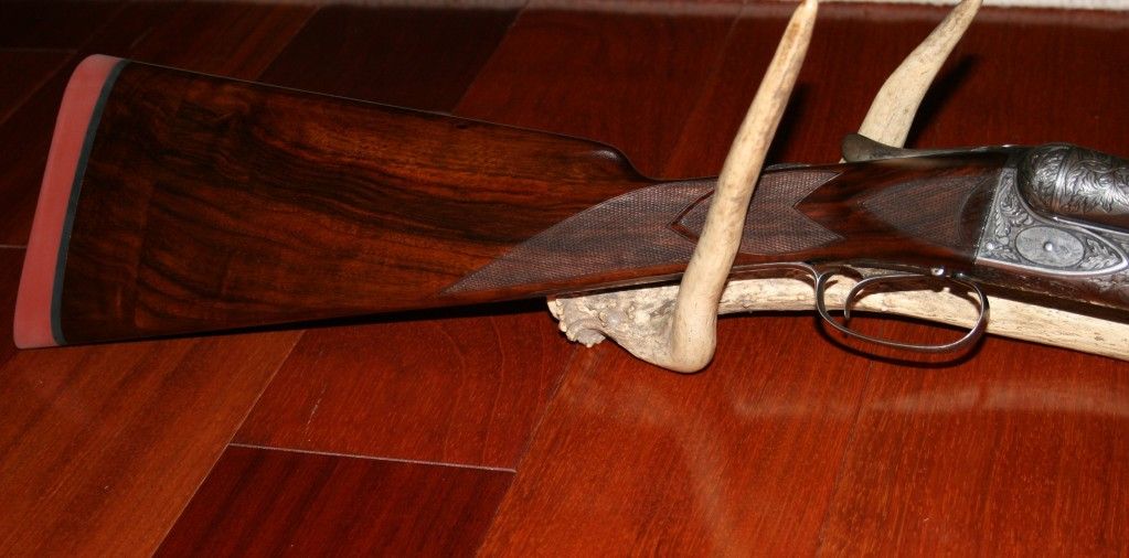

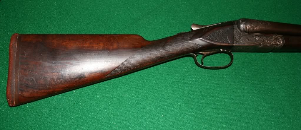

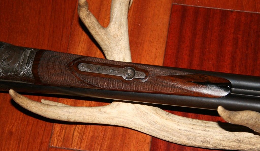

This XE Fox was a crusty basket case when I bought it. Craig Libhardt of Susquehanna Stockworks did wonderful job. There was a deep gouge that you can just see to the left of the ebony forend tip in the before picture. I do not even notice it when I look at it anymore.
He also put an extension on it that was needed. He blended it nicely.
