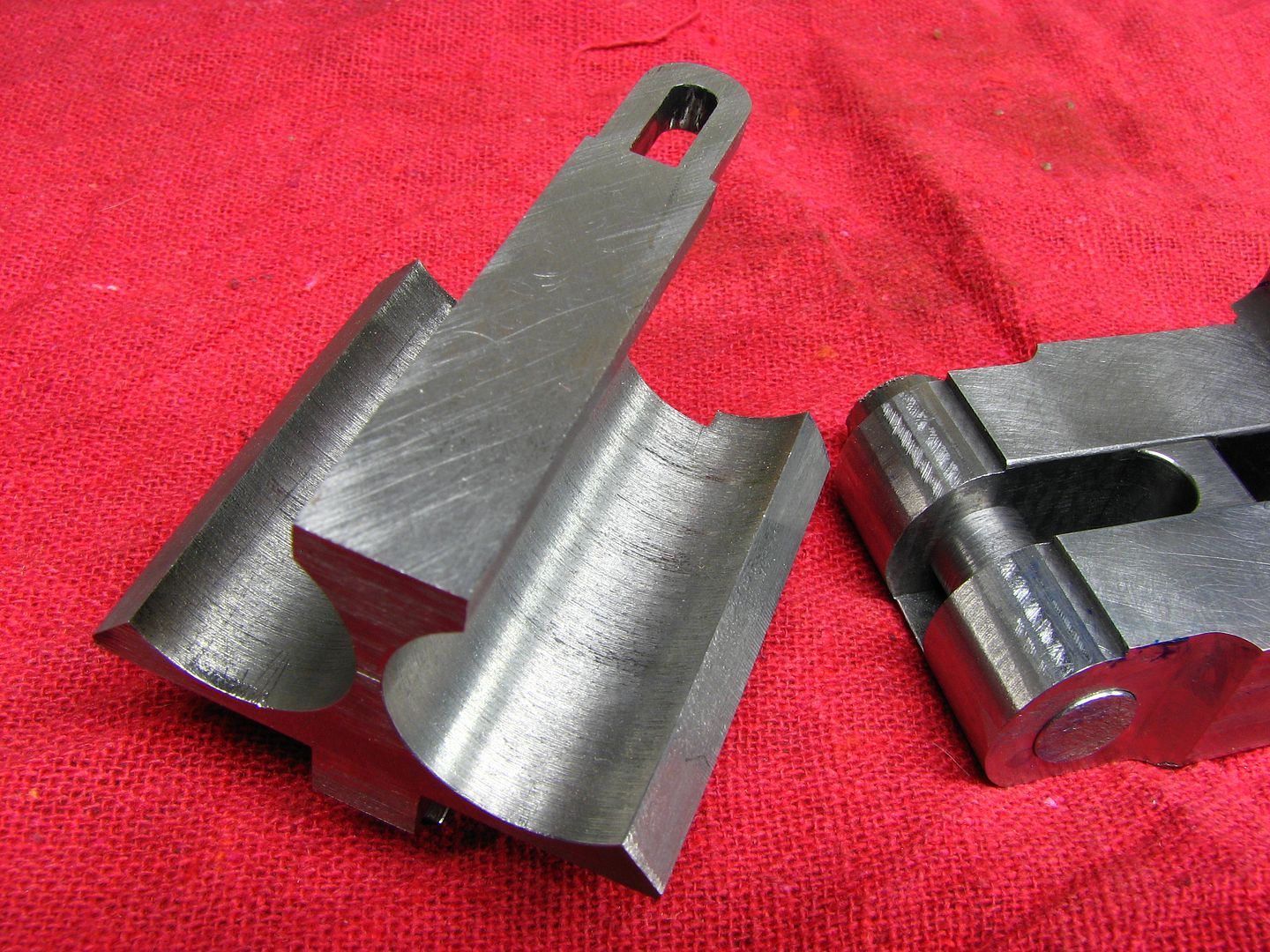

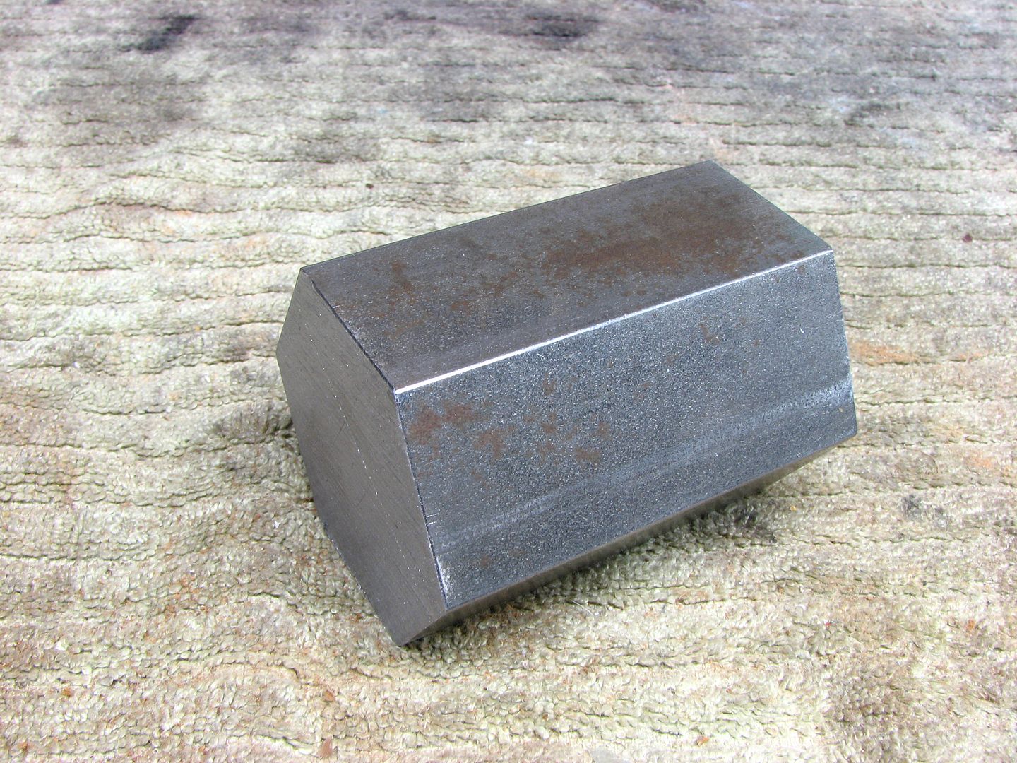

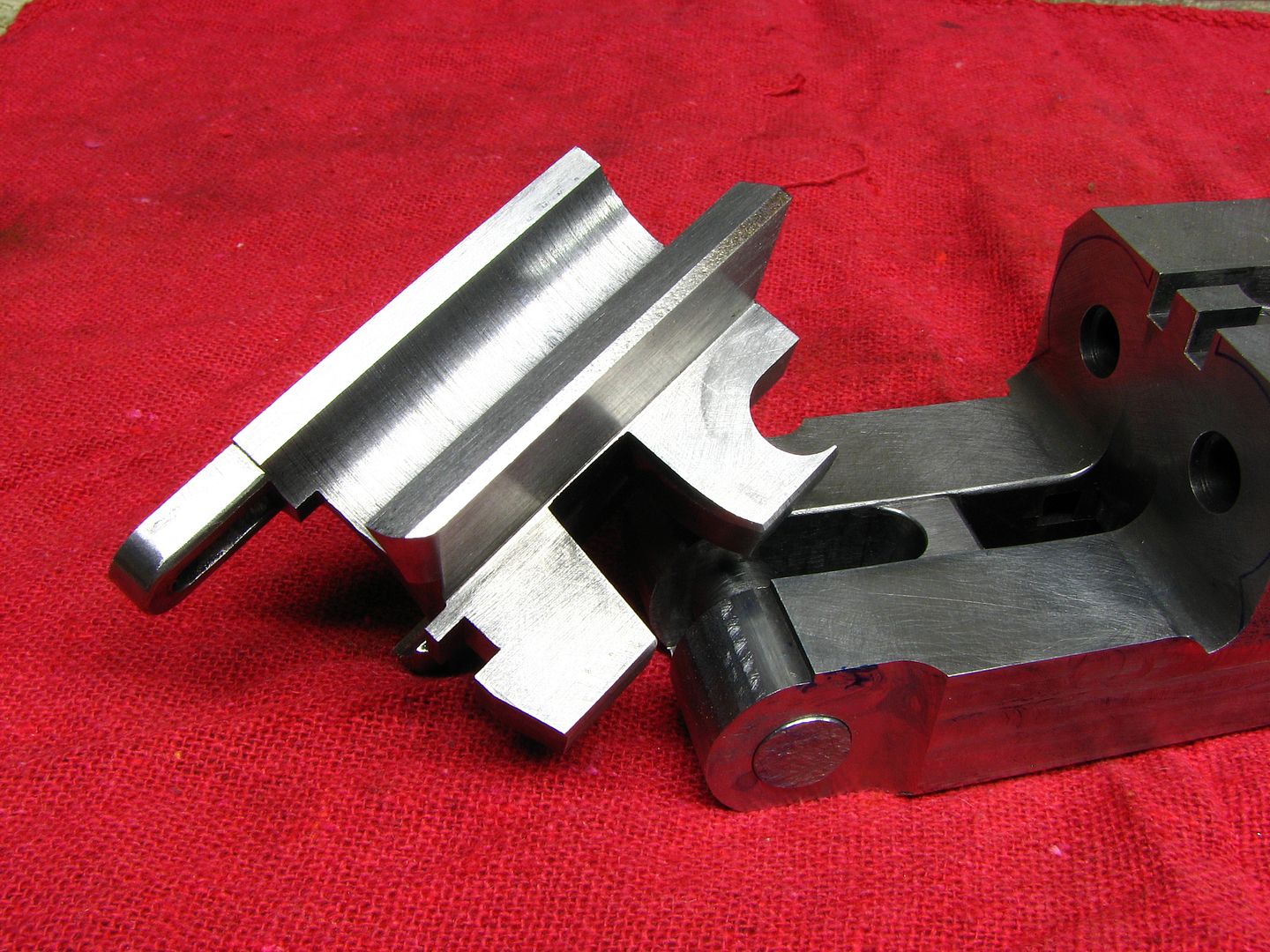

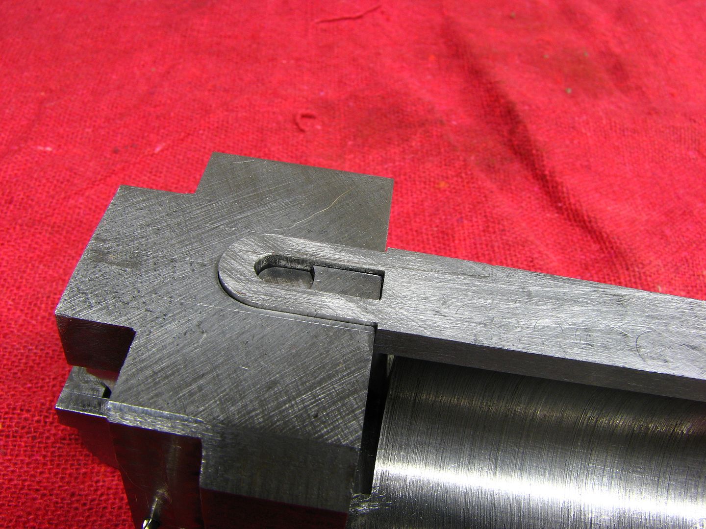

I'm actually going to use a combination shoe / through lump.
Here are a few photos of the lump. The extractor bore still needs to be machined. The first photo shows the chunk of 4140 that it was machined from. The front surface of the rear lump will bear on an hardened insert dovetailed into the frame.
