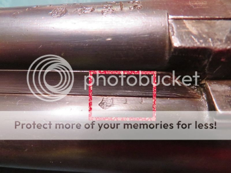

One of my gun buddies and I just did a little trading and I came out of it with this German drilling, 16x16x222 Rimmed. At first because of the Herold name on it, I thought it might be a Franz Jaeger but because the rifle barrel is 222 Rimmed I am skeptical as the few historic accounts I can find put the 222R as being developed in the early 60's and Jaeger passed in 1957, I believe. I am hoping some of you fine gentleman can help me sort this one out. It came with 100 rounds of 222R brass and the Hensolt Wetzlar scope. Thanks in advance.

It is either a Franz Jäger or Simson sourced sporting weapon as that is their patented lockup. Would fancy an image of the top rib extension and of the water-table. The original chambering looks to be 8x58 - maybe Sauer and possibly converted? Do a chamber cast. What is the jagged encircled stamp near the forend hanger? Made between 1912 & 1912. Is the name Meffert in Hamburg or does the name begin with a V?

The rifle was proofed as an 8x58R as Raimey said, and relined to 222R.Due to the absence of reproof marks, I opine that it was relined in the US, or at least somewhere other than Germany.It was also chambered for 65mm( 2 1/5- 2 9/16 ")shells.While it was being relined, it may have had the shotshell chambers lengthened to 2 3/4" at the same time, also w/o marking.It looks to be a "fun" drilling ,if no longer especially collectable.In my unlearned opinion,it is a Franz Jaeger.

Forgive my ignorance, but where is the water table? The name does begin with a V, though many of the letters are hard to make out. My best guess is VANORIY or VAVOBIY? I looked at it with a 5x loupe and still couldn't say for sure what all the letters are.

Water-table is the top of the frame where the tubeset mates with the frame. Also, the rib extension I'm curious about is the top rib where it & the Greener crossbolt mates with the frame.
I see now it is F.W. Vandrey & Co. of Hamburg. That explains the jagged encircled GS(or is it GG??). Did you acquire this from Cabelas of Richland, Wisconsin? I called there to get an opinion on the calibre & really could not get the fella to explain or describe to me the liner or if there was a liner.

Curious what these marks might be. S in a shield & LL, SI, LLH??
F.W. Vandrey hung out his shingle in 1919 so the sporting weapon would date between 1919 & 1923.
