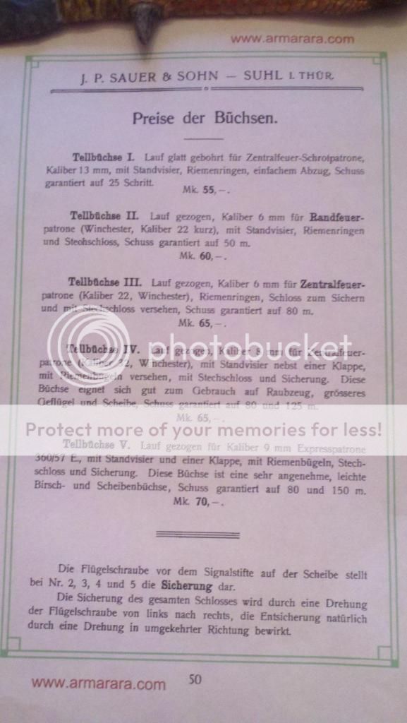

Let me acquire the next page.
Posts: 12,841
Posts: 12,841
Tell - Tellbüchse I - V - Price
Tell - Tellbüchse I - IV - Patron or Cartridge
Ah, there's the date, 1907, & the source.
Tell - Tellbüchse V - Patron or Cartridge
From your verbiage this is yours - 9.3X57R(360) - 9.3mm diameter, 57mm long - Rand-rimmed, based on 360 BPE - British Black Powder Express - Express after Purdey's comparison to the British Express Trains
