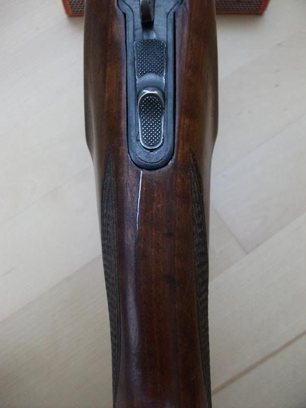

Fin2Feather #378686 09/24/14 11:23 AM
Joined: Jan 2013
Posts: 1,169
Likes: 266
Joined: Jan 2013
Posts: 1,169
Likes: 266
I did post how to glue a crack in wood previously but I would also like to say “if it aint broke don’t fix it” In the photograph is my very early you could even say vintage Baikal O/U you can also see a crack which I have rubbed some chalk in to make it obvious. This gun has been heavily used and the crack was there when I purchased the gun some forty years ago now and it has not become any worse, I could easily repair it but I have taken my own advice “If it aint etc”

Thanks all. Since my natural level of motivation tends to the procrastination side I'll probably follow the "leave it alone" suggestions laugh.
