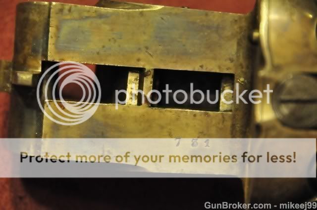

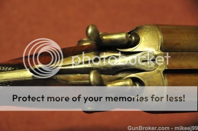

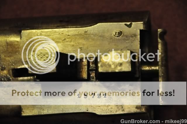

Charles Daly 10 bore hammergun in the 157xx serial number range:
Then encircled PB is the same as that of Joe Wood's latest acquisition and in the same location. But the stamp on Joe Wood's appears to have a couple of efforts.
Just pulled some images from many pages back.
