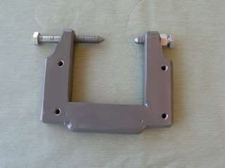

Handy drill guide I use on longrifle stocks which are very awkward because of length to get all positioned with a vise and drill press. The screw on the right has been center drilled to let a 1/8" bit pass through. I have another for 1/16" drills useful for longrifle pins. Greatly expedited accuracy and production with all the holes required on longrifles. The gap between jaws is 3". I normally drill half way from each side, swapping the guide around takes just seconds. Use it with my cordless drill or old hand drill. .

The main thing to remember is to only drill about half way through each side and to repeat this as you change to a larger drill. If the hole has wandered a little in the middle you can straighten it out with the next larger one.

Jerry, I would like to get a hold of one of those fixtures. How about helping me out with info on same. Ken

Slick as a whistle, Jerry V. Reminds me of the hollow cup center also used in the tailstock of wood lathe for boring lamp standards. Unlike with your device, spindle was powered by live center in the headstock and the lamp or shell auger held stationary and pushed by hand thru the hollow center. Your rig another "Wow I wish . . . !" idea.

Jack, fixture wasn't my invention. Lots of the boys at Americanlongrifles.com use them which is where I copied the idea from a true master builder.
