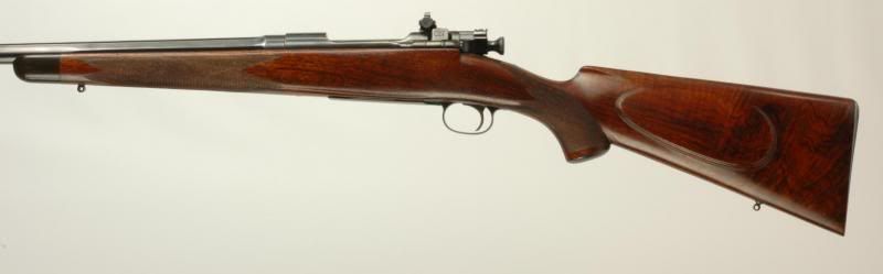

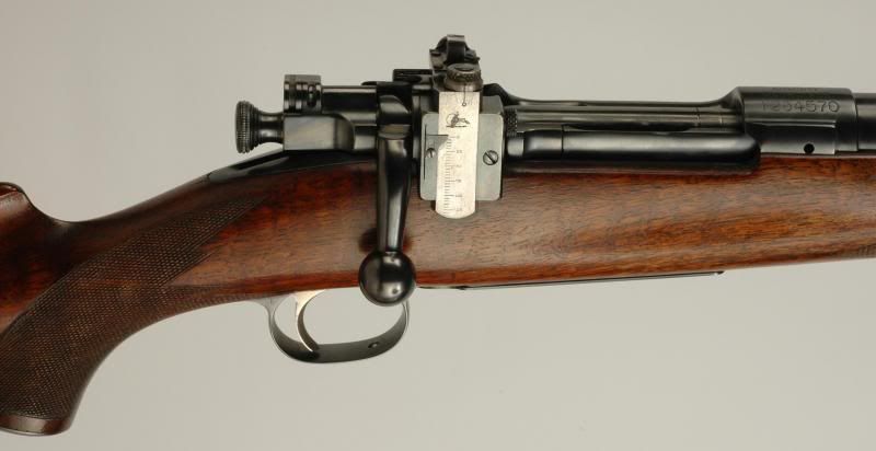

What is the trigger in this rifle? I see a small screw head on the bottom in front of the rear guard screw and what looks like a hole in the bottom of the guard. Maybe a single set?
Dan

Michael, What is the trigger in this rifle? I see a small screw head on the bottom in front of the rear guard screw and what looks like a hole in the bottom of the guard. Maybe a single set? Dan
Dan, it's a "Pike" self setting set trigger. More on this trigger at a later time.

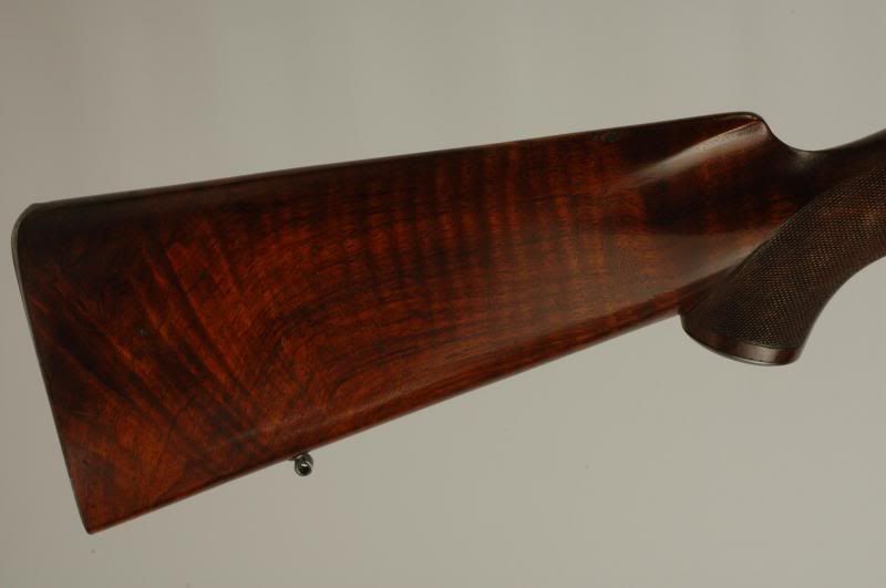

This was the stock that convinced me that raw linseed oil was the way to clean a stock and not destroy the original finish.
