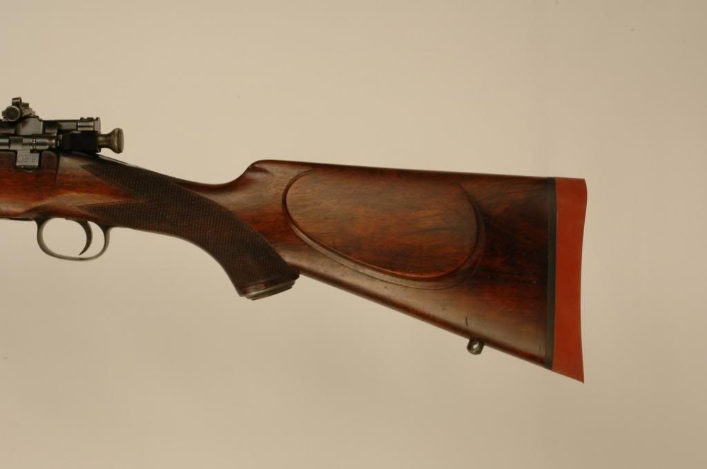

Some breaks and cracks should not be fixed IMO but that's up to the current caretaker.
This is Townsend Whelen's Wundhammer with a cracked stock on the left side, I don't know the story behind the crack so I'll leave it alone.

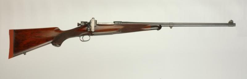

What are some techniques to deal with light rust/spotting on the polished bolt body, bolt handle, extractor and Lyman 48 slide? Such as on this rifle:
[img:left][/img]
I would start with Hoppe's No. 9 and 0000 steel wool.
Joined: Mar 2006
Posts: 114
Joined: Mar 2006
Posts: 114
Just tried the Hoppe's and steel wool, it worked slick! The bolt handle cleaned up nicely. The worst part, which was the extractor collar, looked pretty bad but cleaned up so you would never know it was rusted.
Do you recommend the same technique for cleaning up the blued parts? I would think the steel wool would remove bluing. Maybe bronze wool?
Try the same on the underside, if it's a good rust blue no harm will come to the rifle.
