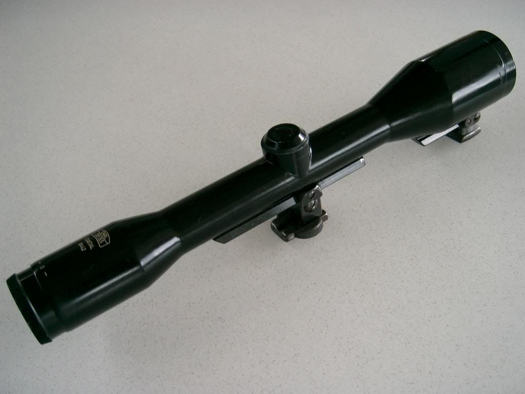

your two post's were a bit of a coincidence as just before Christmas I bought an old Carl Zeiss Diatal scope in good condition complete with mounts from the internet. It arrived the first day we had post after Christmas and was very pleased with what came out of the box, except for the screws on the mounts which were all stuck fast.
Emailed the seller and he said send it back and he would refund my money.
Phoned my gunsmith the same day and he said no problem and told me he would do exactly what you two chaps have suggested.

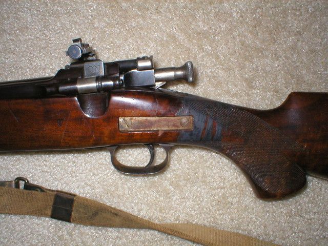

This rifle I bought years ago because it had a long slide Lyman 48, a nice buttplate and engraved floorplate. The maker was unknown, still is, and the work was not top notch so I tried to put it back together myself. I made several mistakes that I , hopefully, learned from.
The rifle had been broken in two, a 1/4" steel plate was inletted into the side and then wrapped with many layers of black electrical tape. A piece of the stock was gone at the bottom of the buttplate.
My biggest mistake on this rifle was I cleaned up the area where the steel plate was then fitted a piece of wood into the hole.
What I should have done was set it up in the mill, mill every this out and round both ends. The vertical ends make the repair stand out where rounds ends would not have.

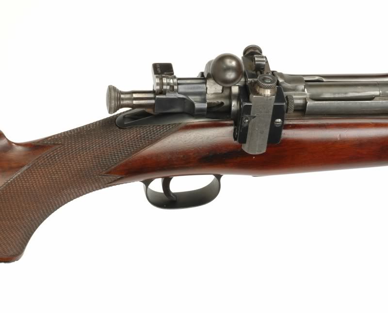

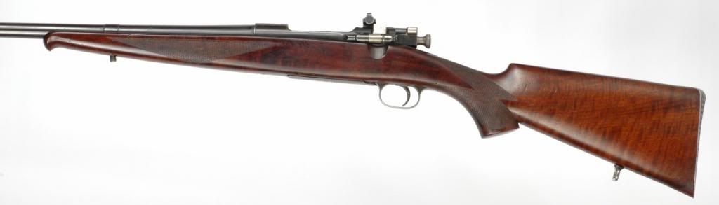

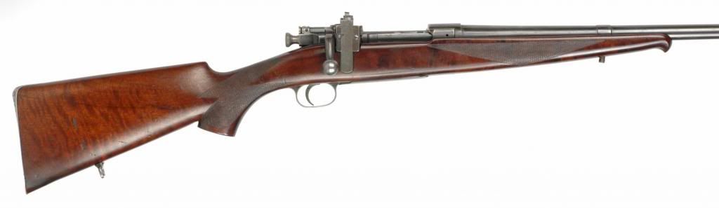

Here is what a professional job looks like. The stock and the action were both cut out for a bent bolt.
