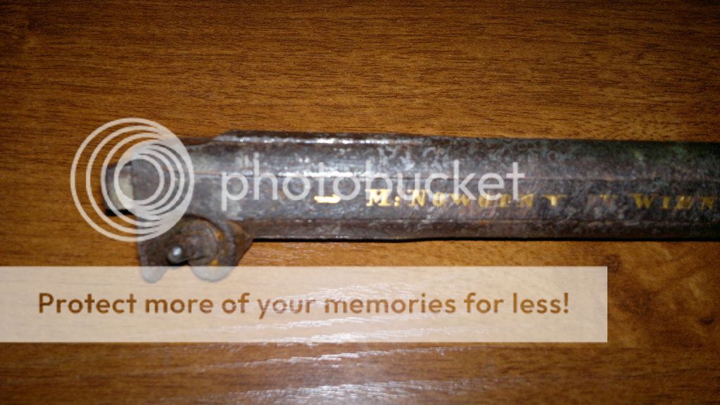

Mathias Novotny Wien percussion single

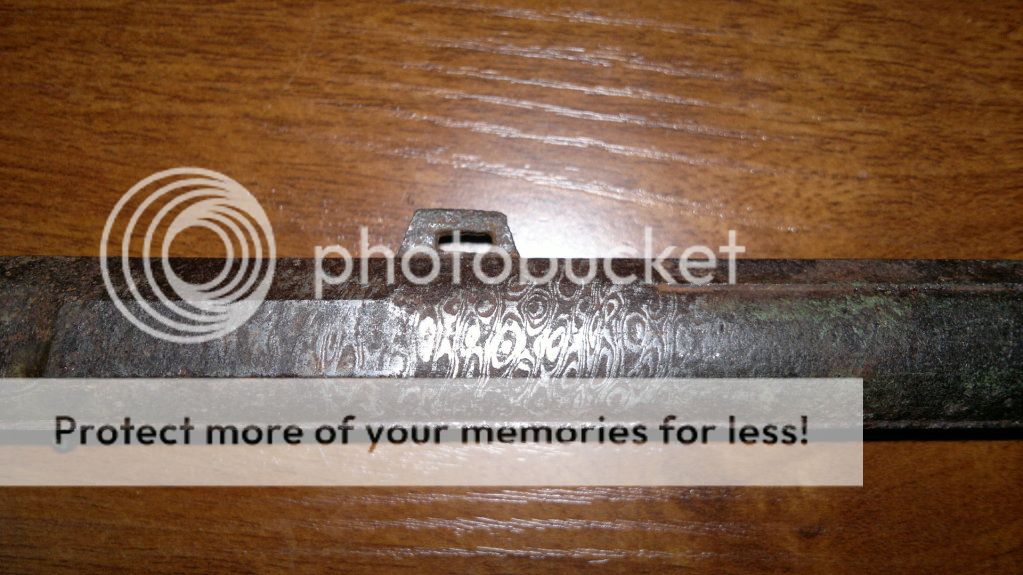

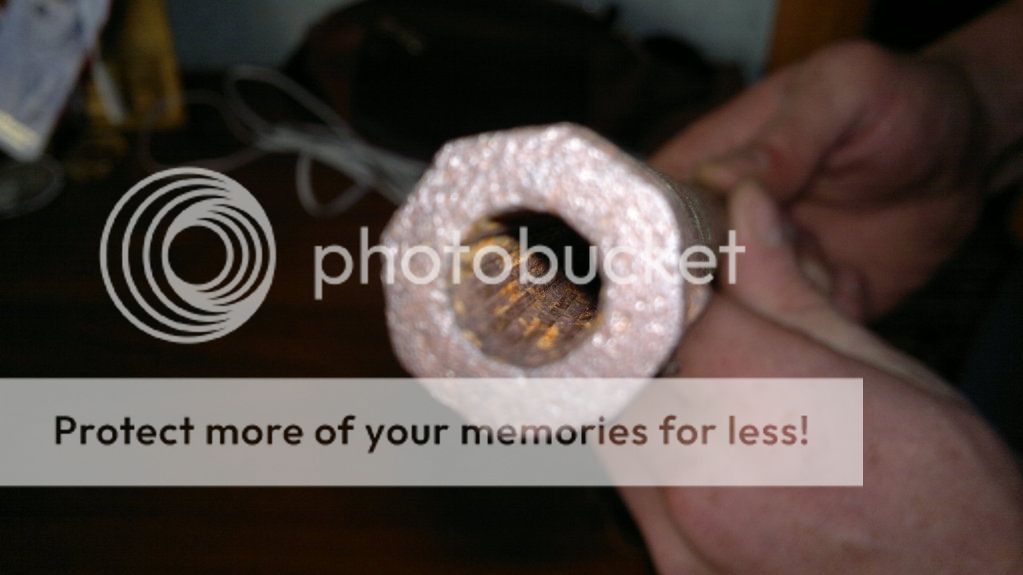

I realize the tube is in rough shape, but are we looking at the odd pattern or is it odd due to the fact that we are looking at a different cross-section? In looking at the rifling, I assume that there would be different oxidation rates for the 2 metals?

That is 'Bernard Loop'; a slightly nicer specimen smile

Ah, couldn't see the forest for the trees. So you think that is a Bernard tube?

Not without this
