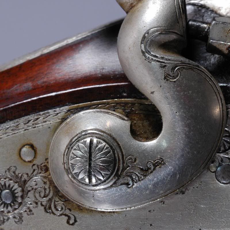

When you find an engraved screw head that has been abused my advice is to send it to an engraver and let him (or her) fix it.
One time I bought a Joseph Tonks of Boston shotgun which had a broken off hammer screw. I got the threaded part out and made a new screw. I then sent the other screw and the one I made to an engraver. When I got it back I sent it to the late Dr Oscar Gaddy who then nickle plated the screw and then remove some nickle to match the other screw. There are no short cuts to doing it right. When all was said and done that was one darn expensive screw ;-).

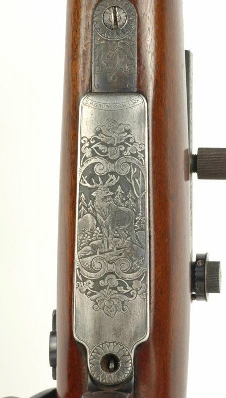

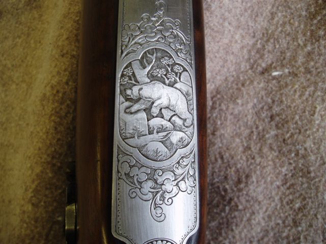

I have a rifle that was engraved by R. J. Kornbrath that appeared to have had the bluing removed from the engraved area. Next to the others of the same vintage it just did not look right to my eye. Many times I had considered rust bluing the floorplate and trigger guard.
One day I called a friend and we talked about rust bluing and carding on engraving. He told me he had the same thing and was thinking of doing his as well. I asked who the maker was and he told me S.R. Griffin the same as mine. We stopped and regrouped and dug out the SRG files and found several that had been done the same way. Seems like SRG like the contrast so after bluing he remove most of it.
So even if you think you know what your doing let a pro look at it. Get a second opinion.
My SRG,
My Friend's SRG,
