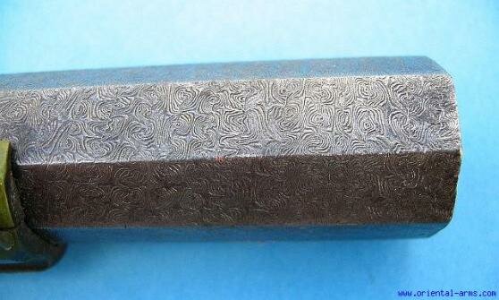

You can NOT feel the pattern, unless the gun has been etched in acid. The barrel has been beaten and ground. Browning should not raise the pattern.
You can feel this pattern.
