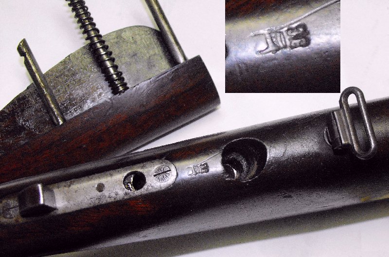

With all the Belgium proofs, I'm assuming Eduard Kettner was only the seller. But, I think there are a couple of German Eagle proofs, but I'm not sure. There is also a strnge stamp (proof?) on the bottom of the stock. So, that's why I'm posting this. Perhaps one of you can decipher the stampings. I'd be particularly interested to know the "year" of manufacture, and who might have made this rifle.

Here are some additional pictures of interest. This is the adjustable cheek-piece removed. You can see the patent number stamped.
On the bottom of the stock, just forward of the cheek-piece height adjusting screw, there is a strange stamp. Looks like a "crown" over a "butterfly". ? ?
