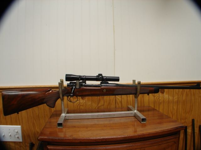

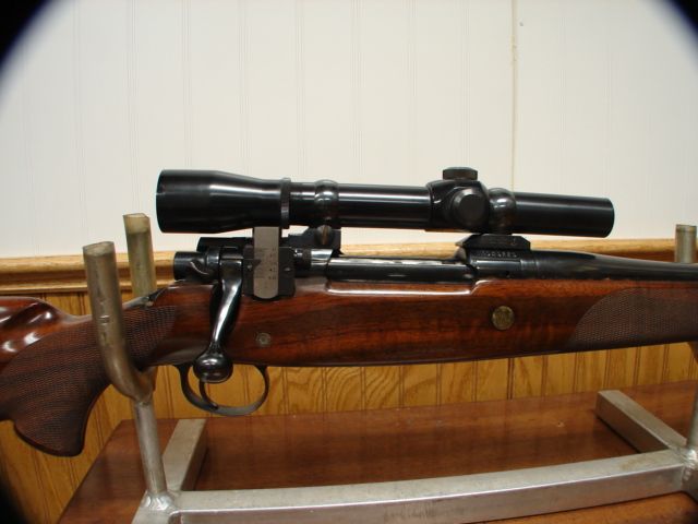

This is a P14 project of mine from the early 1960's. The caliber is .416/.300 Winchester Magnum, a sort of precursor of the .416 Taylor, with slightly more case capacity. .416 Rigby performance was easy to obtain. Metal work by my friend and business partner, the late Harry Creighton, stock by the late, great Hal Hartley.

Thats a fine looking rifle.
