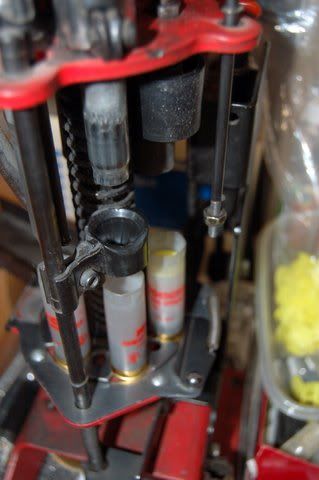

I load my spreaders on my MEC 9000G in progressive mode.

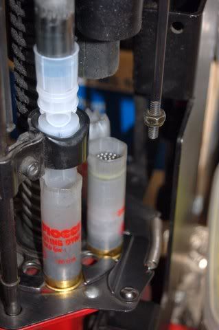

I seat the wad and drop 7/8 ounce of shot. I raise the handle 1/2 way, enough for the drop tube to clear, but not enough to release the shell carrier and index the shell.

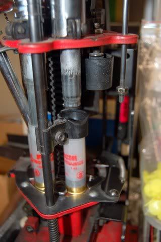

Holding the handle 1/2 way up, I place the PW disc in the wad guide...

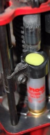

Then I seat the disc with very light pressure, again not enough to actuate the bar.
On the full upstroke the shell with disc moves to the crimp start station and a new hull arrives with powder....

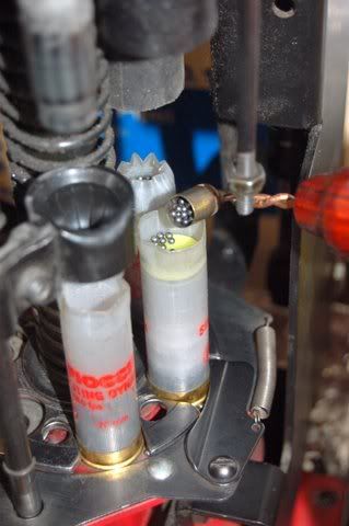

Using a 1/8 ounce shot dipper made from a cut down .38 case soldered to a wire handle, I add 1/8 ounce on top of the disc and continue....
As I seat the wad and drop 7/8 ounce in the new shell with a full downstroke, the previous shell will be crimp-started...
I raise the handle halfway and pause, put a disc in place and continue.
