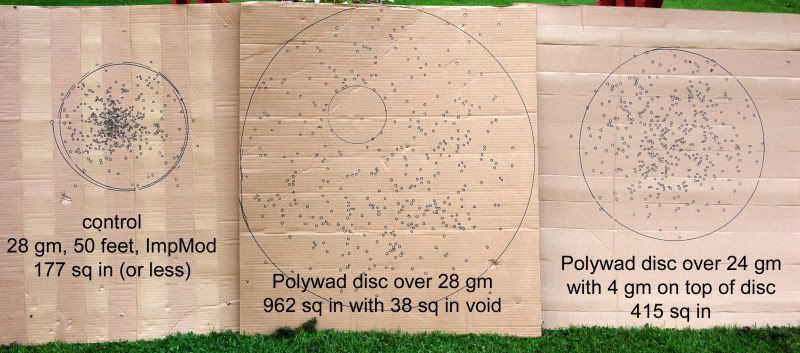

Bringing a measure of control to a chaotic event....the center density at a given yardage can be tuned by adjusting the percentage of shot on top of the disc. No other spreader technology/technique comes close IME.
Mike you gained a convert some time ago. I'm currently working on developing a biodegradable alternative to the spredR disc to be used in conjunction with fiber wads for use in areas where biodegradable components are required.

It is amazing how much the pattern size changed with a small amount of shot over the polywad! In my ignorance I would have expected the opposite result!

Terrific thread! Especially (but not limited to) Mike's patterns.
I have used spreaders for years and find them most effective on tight chokes, less so on more open chokes.

Mike,
All three of those patterns were fired at 50 feet? Out of the same gun and choke?
SRH

Stan,
Yep. Side by each, one after the other. One ounce of 8's (as I recall) through the same barrel of my 32" Fox at a measured 50 feet. Both barrels are .024".
On second thought, I may have fired a few of the "standard" Polywad Spred-R loads to get that result since, IME, a void like that occurs about 1 in 8 times. But they were definitely shot in the same session, same barrel, same 50-foot distance.
I haven't feared a 10-20 yd rabbit target since I started loading them. grin
