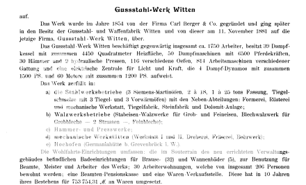

Um, hum. So silver and not copper like the Belgians?
1903 Listing for Witten founded 1854 - at one point 1750 workers
