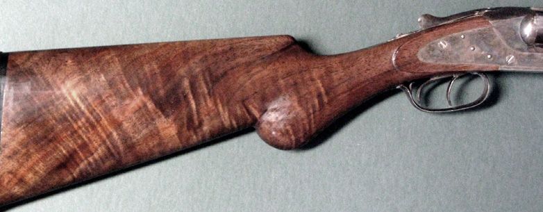

Here is my almost finished stock which I hope someday will be finished.
Bobk, your original stock needs a lot of work before it could be used as a pattern for a duplicator machine. You would need to soak it as Rockdoc suggests and then use bondo to fill gaps between wood and metal (being sure to use plenty of release agent) and to add "wood" where needed to strengthen the stock.

Nice looking stock. The wood grain looks to flow perfect through the wrist. You should make several stocks with wood like this, so I can have one.
