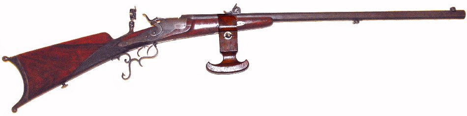

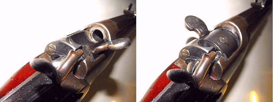

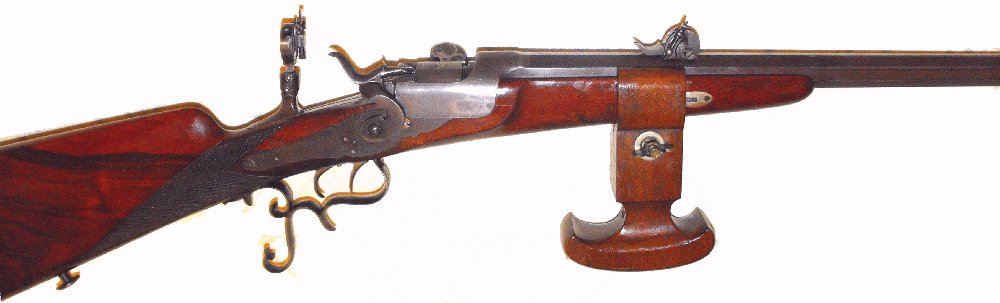

That's very interesting. I also have Werndls with their weird rotating breech-blocks. I have 2 Werndl rifles, a Werndl carbine, and a Werndl Schuetzen rifle built by Steyr & Pest in 11.5x50R. Sorry to get side-tracked, but as you can imagine (based on my interest in the strange little 8mm Lebel Double) - I like "weird" guns.

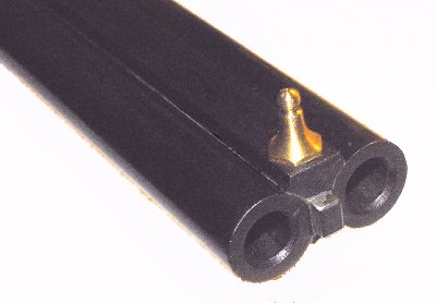

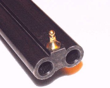

After 3 long weeks, I called for an update. I spoke to JJ, and he told me that he was surprised to find that the front wedge had been "silver-soldered" in place. This was something that he had seldom seen, and then only in a very few instances, and never, on such an old rifle. He was absolutely amazed that a rifle from 1898 would use such high temperature joining.
He indicated that trying to re-regulate with such high temperature joining, would surely cause the barrels to be separated from both ribs, full length, and destroy the original patina.
His solution was to "cut" through the existing front wedge, and insert another wedge in-between, using the conventional temperature methods.
Here is the before, and after of JJ's work. Interestingly, he left the new wedge in place, protruding 1/8" forward of the muzzle faces. Perhaps this was to protect the muzzle, or just to show that something was actually done to the barrels, otherwise one couldn't tell. Total center/center change, was only about .015 inches more spread.
