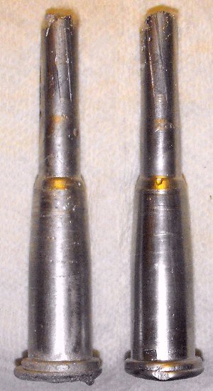

I took some time and did a chamber cast today. My bores measure .3175/.329 left barrel and .318/.330 right barrel. Both are 4-groove, "left-hand" twist.
I was a little surprised by these numbers, as they seem much over standard 8mm. Fortunately I'm an avid Schuetzen shooter and have no less than 42 different bullet molds for 8mm ranging from .316 up to .334 diameter.
I have 3 custom Darr molds, 203 grain .327 Dia. Spitzer, 185 grain .330 Dia. Pope style, and a 245 grain .334 Dia. Spitzer. I also have a Borton/Darr 203 grain .327 Dia. Spitzer that might be worth a try.
The loaded ammo I have from Graf uses a 180 grain .323 Dia. Soft Point. I also have on order some 200 grain soft points in .323 Dia.
Looks like reloading for this will be another challenge.

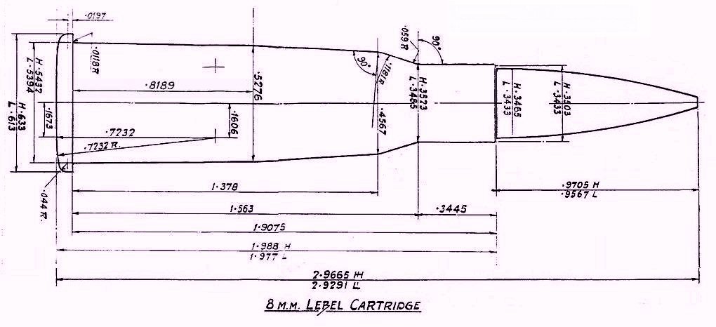

As a side note about the 8mm Lebel. I knew very little about the 8mm Lebel cartridge until I acquired this little double Lefaucheux. I have come to find that this is one of the strangest cartridges I have ever seen.
Over the years I have loaded for over 60 different calibers and developed several that didn't exist, but this is the first, and perhaps the "only", cartridge that has a double taper body. Not to mention the radius of both the shoulder and neck junctures, something that Roy Weatherby took credit for some 55 years later.
I can't wait to start experimenting with it!
