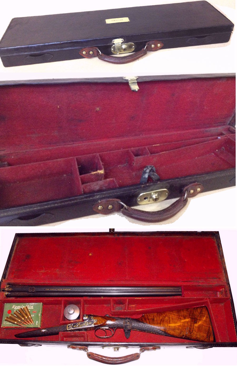

In order to protect my new acquisition, I purchased a vintage leather hard case from England on Monday. Top 2 pictures show it as I received it today. The bottom picture shows it after some clean-up and with a few completed internal modifications to fit the Lefaucheux with its attached forend.
Now all I need is some good weather to get out and try it.
