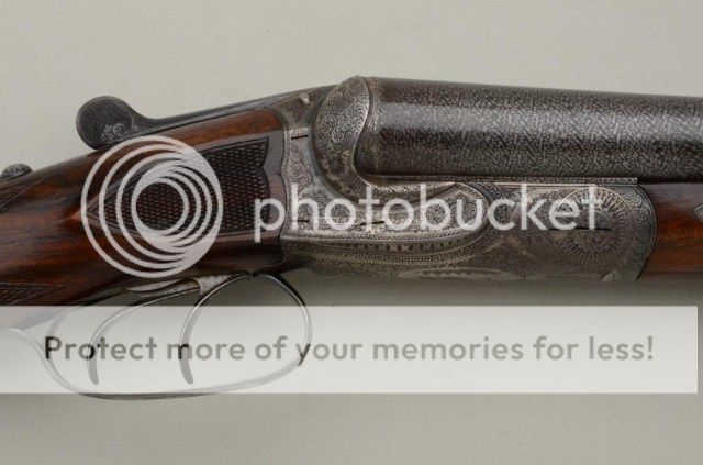

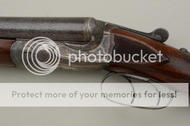

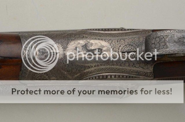

A Russian collector friend obtain permission of use on these Ernst Steigleder Berlin Lindner sourced Diamant Orlow double with an additional set of rifled tubes by Louis Kelber some time later. Some may object, by in my opinion this paring of Lindner-R.S. - Robert Schlegelmilch and Louis Kelber tubesets is about as good as it gets unless there's a 3rd set by Jean Falla.
2 grams of powder over 27 grams of lead shot
Schilling forge marks along with H.A. Lindner's control stamps
Initials L.K. on a rifled tubeset and note the serial number. For some reason unknown for now Ernst Steigleder changed to serial number 111,000 circa 1904/1905.

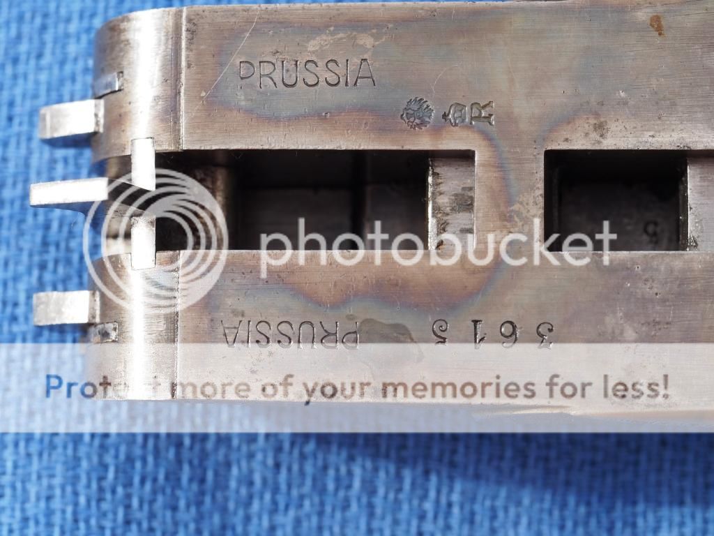

Looking at OWD's recent post I noticed the following Charles Daly Gun-H.A. Lindner and I wondered how many had the side frame reinforcement?
Daly #3615

I noticed the same gun in the recent Little John auction. This is the first Lindner Daly I have seen with this style of action reinforcement. It is interesting, but I can't say I care for the aesthetic.
The first Daly I have noted with Wittener steel barrels is Serial #1130 which puts it circa 1901. Please note though that many of the entries in the database do not list the barrel composition. Witten barrels could show up several hundred guns earlier. This is just the first one I noted with this serial number. Krupp steel is found as early as Daly #705, circa 1896/7.

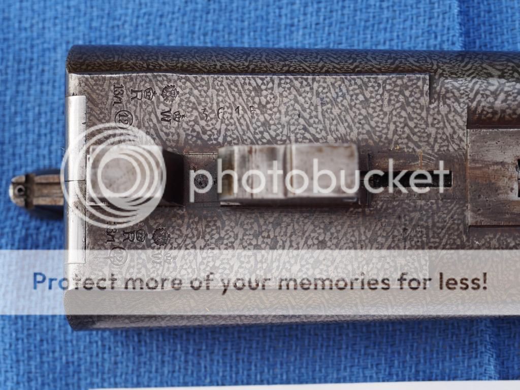

Curious as to the repair and if it left Germany or was sent back?
JW initials
